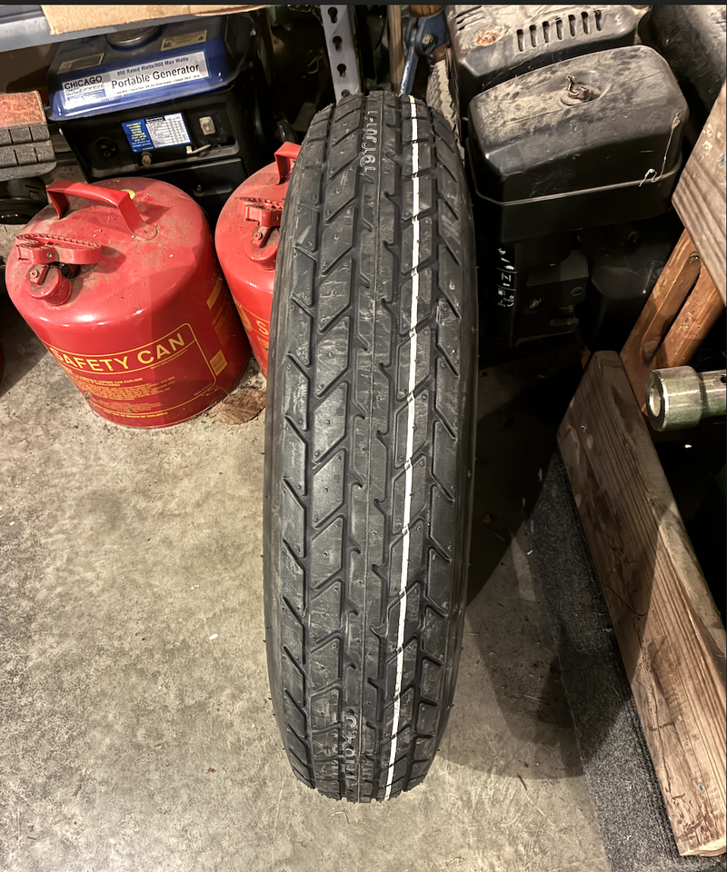

    I now have a new Toyota donut. No car yet, but I've got the donut. It is skinny:
  16. reservoirblue
    reservoirblue Member
    Mar 22, 2024
    79
    56
    Woodacre, CA
    2024 Prius Prime
    SE
    Great! When I bought, it was the only one available without dealer mark-up. I probably would have gone for something less conspicuous, but now I love it :cool:
