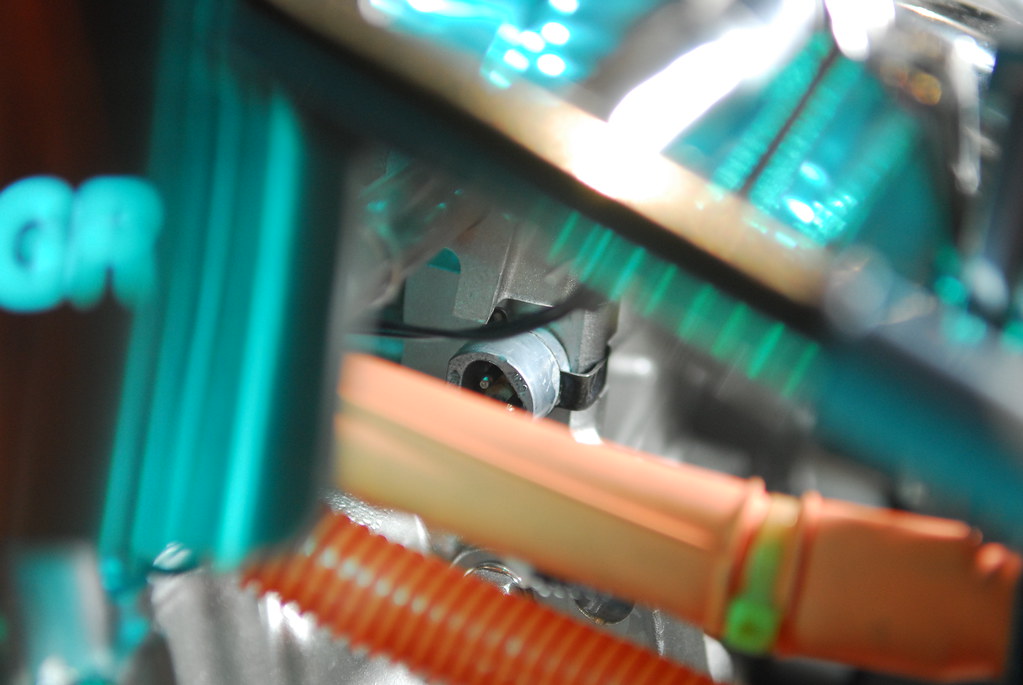

    One of my shots of the one Wayne installed....

    I believe an EBH is still an optional, and it looks the current EBH for 2001-2009 Prius fits on the 2010 Prius as well.
    Wayne already installed it. :)

    With the new exhaust gas heat recovery system it will be interesting to see if Canada still requires the engine block heater. But it still will be useful and the current model, as Ken1784 stated, fits in a hole on the block of the new 1.8 liter just as in the current 1.5 liter. DNA and all.

    Don't be fooled when you see the cutaway Toyota is displaying, the EBH fitted is an after market fitment.
