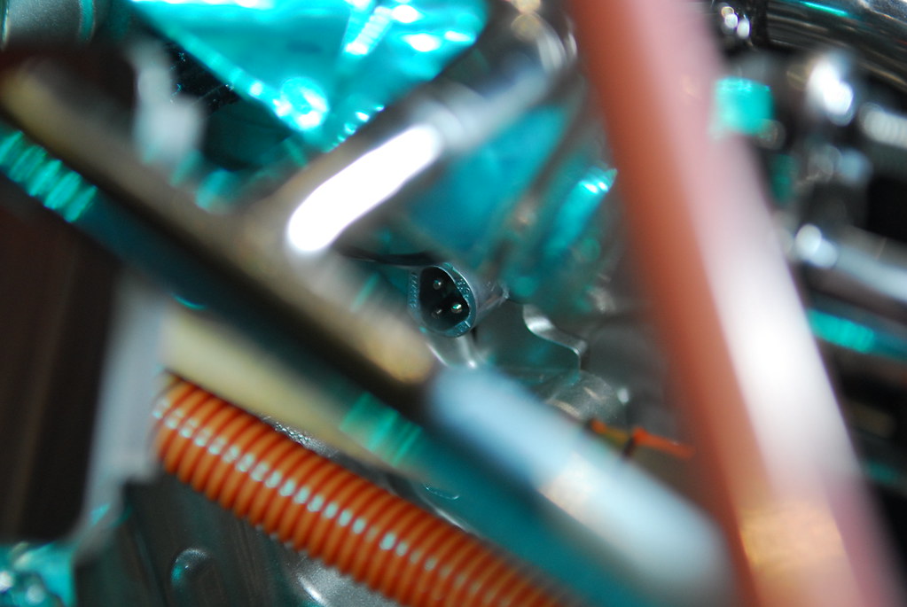

    I believe Wayne has already done a partial install on a partial 2010.
  10. qbee42
    qbee42 My other car is a boat
    Mar 2, 2006
    18,058
    3,076
    Northern Michigan
    We watched him do it.
