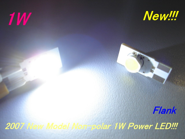

  20. Bill Merchant
    Bill Merchant absit invidia
    May 3, 2005
    4,096
    85
    USA | Oregon | Portland area | 97004 |
    Wryter, if you are thinking about changing the front door lights to LEDs, they are 168 wedge too, but you will want to get a side-firing (flank) LED since a front firing one (like you've ordered) will send most of the light inside the door. Something like this:
