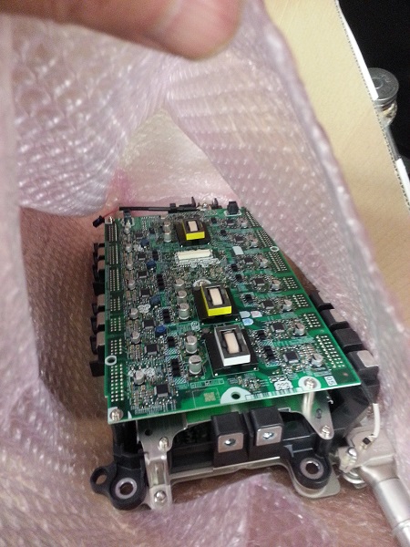

    I hope this is my last post about this and I can go back to fun stuff like lighted door sills and body kits. First off let me lead by saying that to their credit, the chemical folks said "fix it and we will take care of it". So kudos to them.
    @IMkenNY, thankfully I didn't have to worry about trying anything on my own. But good looking out with the back flush machine.
    @JC91006, The stuff was put it in without my knowledge. It probably works great in a regular gas engine radiator. But according to Toyota (who we have to call and open a case on certain DTCs), it is rotten in your inverter cooling system. They claimed that mine is not the first one they have seen. My thought was that someone needs to tell somebody. So I did... here.
    @bisco I looked into that when all this started and my code was not one that was included in the recall or the warranty extension. Trust me, I checked every angle to keep from losing all my Christmas money.
    Now for the fix (hopefully). I don't understand all of it. But I understand enough to get most of what the guys in the shop are telling me. If any of you techs want to chime in and clarify or correct, please do.
    This is the Intelligent Power Module or IPM. In my parts catalog, you have to order the whole inverter assembly. But evidently there is a bulletin now where you can get the component parts. This is one of those separate parts.
    See the coolant passage at the bottom right? Take a look how tight the passage is when you look down inside it.
    So yeah IMKenNY I bet it could be a foil top or debris in the flush machine or who knows. We probably never will. But the techline told us that replacing this part will solve my problem. So one of the guys changed it today (what a process that was to watch) and I will be riding it home tonight. Hopefully this is the end. But like I said, it could have never begun. No additives! Thanks for listening and I hope this helps someone!
