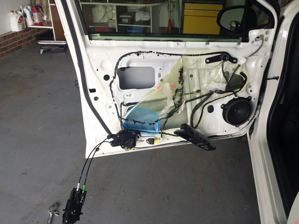

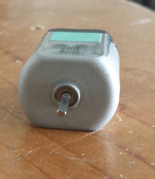

    Update replaced the small motor in the door lock actuator took about 1.5 hours to fix. Cost a whopping 5.50 on ebay I will post pictures later. By the way dealer wanted 600.00 to replace. Here is the picture of the door broke down and a picture of the little motor.

    Wow only $5.50 for the original part on ebay?

    Glad you fixed it yourself. What an unbelievable savings.
