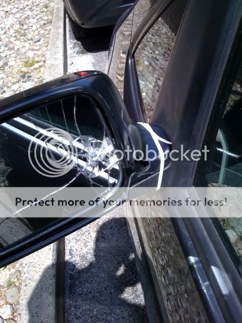

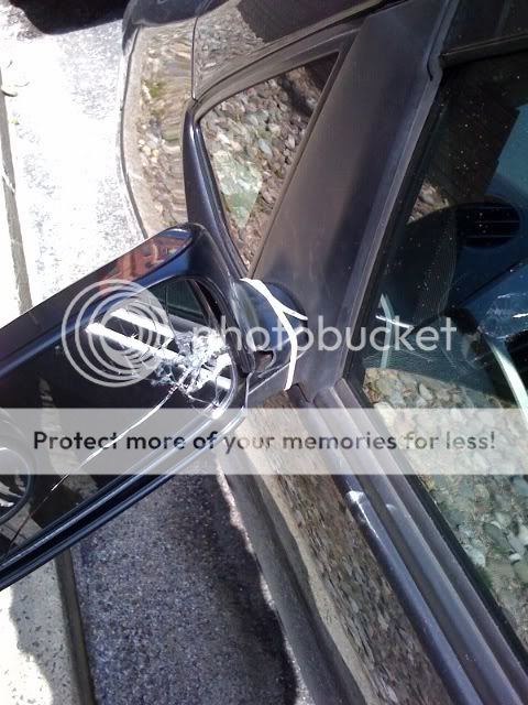

    oh well this morning, while reversing i didnt noticed the security lock box on our building and i got this damage! the sidemirror completely fell-off and a broken glass! i called toyota and they quote me $350 all in all....

    $350 installed sounds about right. It looks like you need an entire door mirror assembly, and the part alone runs about $200.
