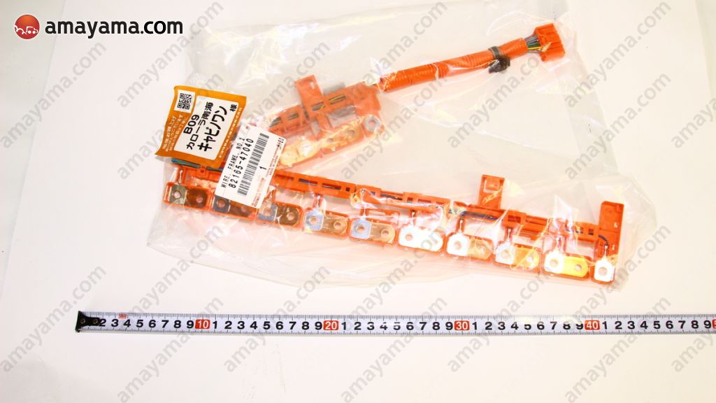

In the workup for P0AC0 you may see step #2 (on page HB 69), which gives instructions that include the voltage and resistance values for testing the HV battery current sensor. There is an additional way to inspect the sensor by probing the terminals for resistance. Follow the step-by-step instructions on page 142 (HB 142), this would also require the use of a multimeter. There may be no need to replace this battery current sensor if it tests good. For DTC P0AFA, inspect if voltage sense harness is the issue, or where it makes connection to the HV battery ECU. Images below. You can purchase a new OEM harness for around 60usd at the toyota dealership. If none of the local dealers are price competitive, then you might try ordering online (be aware of import duty if applicable) : Buy Genuine Toyota 82165-47040 (8216547040) Wire, Frame, No.2 for Toyota Prius. Prices, fast shipping, photos, weight - Amayama
