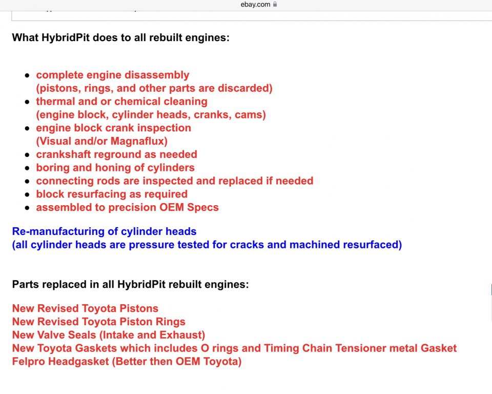

    Strangely changing the plugs will "fix" it for a few days to a week in most cases. So give your wife a psychological win to build brownie points to buy a gen4 or hybrid pit engine for a swap.
    In the meantime:
