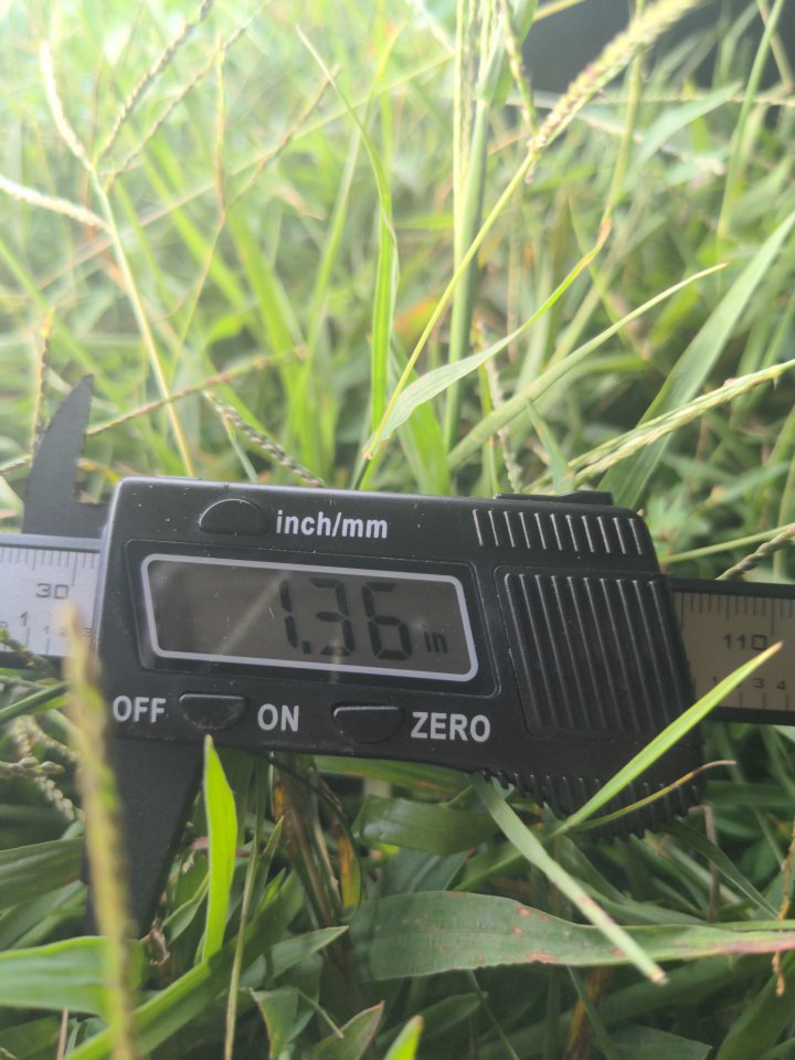

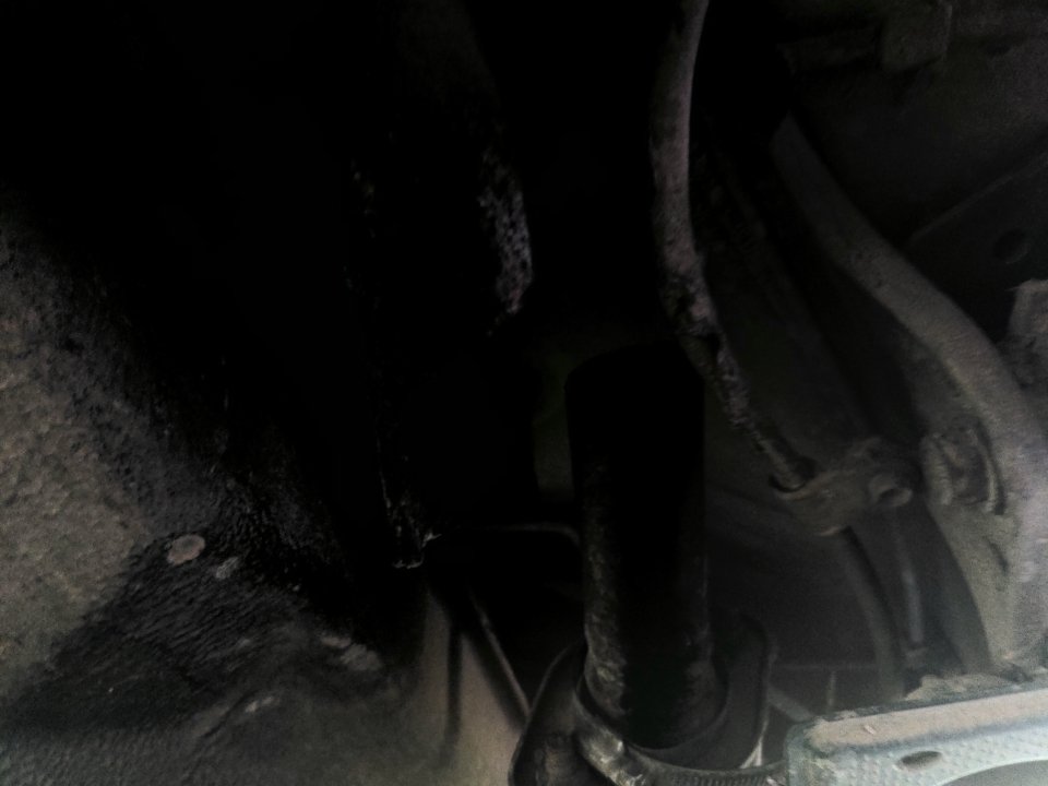

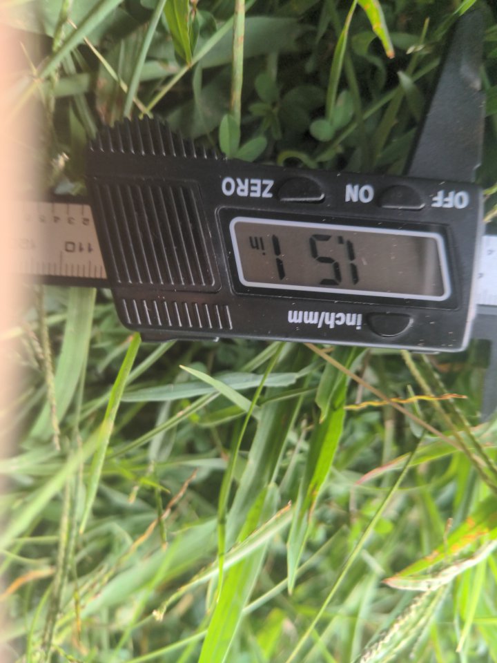

    I was looking for these and didn't find them, so I got some calipers and measured them myself for the next person with a broken exhaust pipe between the muffler and muffler connector.
    1.51 outer, 1.36 inner
    Not sure how much corrosion affects that, just looking for a temp fix till I can get it fixed proper.
