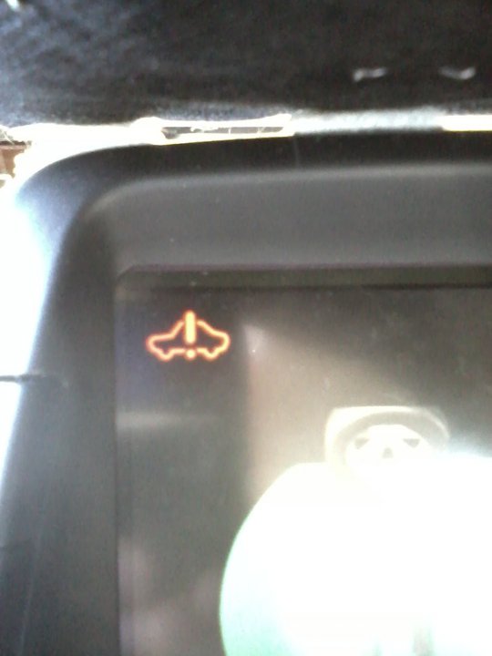

    pushed the mileage too much, on two short trips after low fuel beep, finally in the middle of hwy, all hell broke loose, all lights turned on and blinking, limped half a mile with HV battery, Thank God it was just at
    the exit and a long ramp downhill, walked another 2 miles to gas station, prius alive now
    take:1.add gas ASAP 2.leave a 1 gallon gas can in your car, neither 76 and chevron I walked to had a gas can for sale, walked another mile to NAPA and got one
    strange light that never been seen before

    Hi CaliforniaPrius. Did your Prius start up without any issues after you had added enough fuel? Some people have reported that their prius is reluctant to start (until code is cleared) after running out of fuel.
    Also just wondering, how low did the SOC (bars on battery charge indicator) go before you stopped?

    I was lucky b/c it was a longggg downhill and I was right at the exit. I didn't want to stop on hwy such that calling for Geico was the only salvation which might take couple of hours. Now I could still refuel by myself.
    The battery bar was still green when I stopped in the parking lot. After I added 1 gallon of fuel, the signs were still flashing but start up was no problem.
    I used to drive when the fuel bar is flashing for about another 40 miles without issues. When I refuel, it was only like 10 gallons so that by calculation, 40 miles after flashing, there should be like 1.9 gallons left. This time it was only short trips in town like 1-3 miles so I didn't think it a problem until too late.
