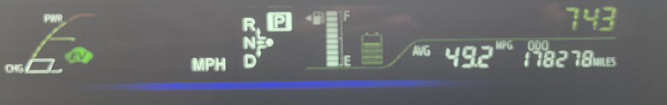

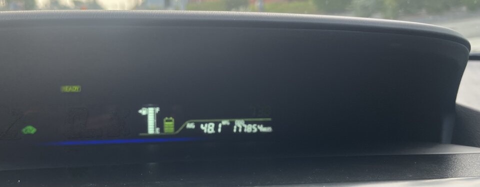

    We took home our “new-to-us” 2014 Prius v Five last Monday morning. Since then I have put on 405 miles (estimated 70% street, 30% highway miles) before the first fill-up with the gas gauge reading 3 bars remaining and 79 miles of driving range remaining. The average (AVG) indicator read 48.1 MPG. I put in 8.512 gallons; that works out to 47.6 MPG.
    (Note: I debated whether to drive the Prius until the gas gauge read one bar, but I did not want to run out of gas and I wanted to take advantage of the cheap Costco gas on my way to work this morning.)
    Overall, I am generally happy with the Prius v. It handles well, stops on a “dime,” rides smooth, and is fairly quite. I love that I am getting great gas mileage per gallon; it is a welcome change from the poor gas mileage of our other cars. I like the Prius’s informative instrument panel, but I wish there were readouts of engine coolant temperature, inverter coolant temperature, voltage, etc. I bought a small OBD port reader (ScanGauge II) to put on the dash to display this information.

    UPDATE: I was curious why the calculated MPG (47.6) did not better match the Prius’ AVG MPG (48.1) as shown on the dash cluster. Then I remembered that before driving the Pirus off the lot, the salesman asked me if I wanted one last test drive with him. So, I drove it on some city streets for maybe 3-4 miles. And then, at the gas station this past Sunday, when I filled up the tank, I topped it offer at it the pump stopped automaticallly at (I think) 8.46 gallons. So, if these are taken into account, 408 miles / 8.46 gallons = 48.2 MPG.
    P.S. I know that topping off is not recommended. I just did it this once, and will not again on this car.
    Since filling up, the AVG MPG readout has been between 48.0 - 48.6. I am still amazed. I would have had to fill up our minivan at least twice during this same week, and it has a 20-gallon gas tank.
