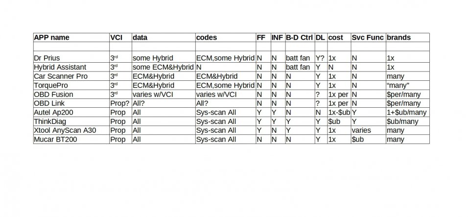

    Ok, if ALL you want is to do is monitor HV battery block voltages, then Dr Prius is adequate. Get whatever OBD device that will work with your phone - IDK from your Nexas.
    Just be aware that Dr Prius is very limited: the data you see is pretty much all it can do. Read/clear ECM codes. It is inconsistent in what codes it can read from the Hybrid Control & HV battery ecu's (it can clear all HC & HVb codes).
    No INF sub codes.It cannot talk to any other systems.
    Many people who post on the forum end up needing a more capable scantool to diagnose their Prius.

    Results for the least (assuming you have a laptop or pad with usb) would be a miniVCI clone or openport clone for 25usd, and techstream.
    This link can explain the difference : https://blog.obdii365.com/2022/07/13/mini-vci-vs-openport-for-toyota-techstream/
    If you end up going with the miniVCI cable, then read : https://blog.obdii365.com/2022/10/16/toyota-techstream-mini-vci-v1-4-1-vs-v2-0-4/
    If you end up going with the openport clone, then read : https://blog.obdii365.com/2022/03/23/how-to-choose-the-right-clone-tactrix-openport-2-0-j2534/
    A few posts down that thread starts reviewing handheld options, which all cost over 50usd, though one may cost 56. Dr. P is mostly useless.
