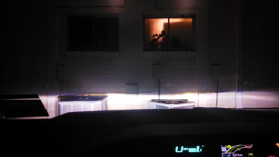

    I'll try to find a picture of the HID kit I plugged in to the fogs. There was so much glare, it was unbelievable. I plugged the halogen bulbs back in.
    You can see how high the yellow light goes compared to the second picture of the low beam cutoff. That is all glare. And that's about 2 feet away from the wall. You can see the yellow circles of the fogs reflector housing. Imagine driving and seeing this glare coming towards you. Not safe at all. This is why Plug in play HID kits, in reflector housings are bad.
