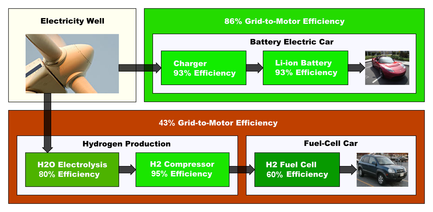

    Oh a quick chart, in case you want to produce the hydrogen from wind.

    This chart is not accurate. For plugins like PiP, charging loss is about 15% so charger efficiency is 85%. Battery efficiency is listed as 93% but you'll have to consider other losses. BEV is about 85% efficient. Grid-to-motor efficiency becomes 72% instead of 86% on the chart.
    FCV efficiency is 59%, not 40% the chart indicates.
    The advantage of Hydrogen is, it can be easily (relatively) stored, vs. battery for electricity. Wind power is intermediate and unreliable. Without added reliability of fossil grid, it'll need utility battery pack to store it to charge the BEV. Storage aspect is ignored by BEV proponents.
