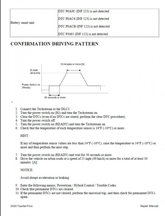

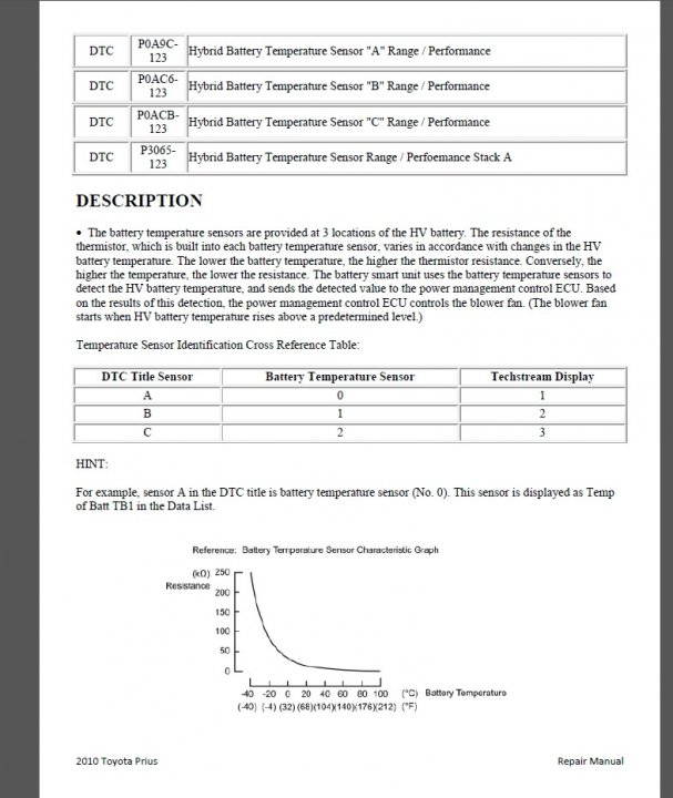

    here are some interesting extracts prius manual might be helpful
    the temperature trigger may be just under -10 degree cel...If second sheet is anything to go by .....just under hint
    Maxwell61 likes this.

    Excellent Ed! Yes, it is'nt directly stated, but is quite clear that -10° C is the figure for the freeze mode. The correct figure for the impedence @ the sensor should be then a bit more than 50 kΩ. It should be possible to enterely bypass the actual sensor and go for a fixed resistance of that order. I'll speak with the person in charge and i'll let you know. Can i repost the pics in our forum?
    Also, from the procedure of the manual, it seems to be confirmed that a single sensor manipulation should be enough.
