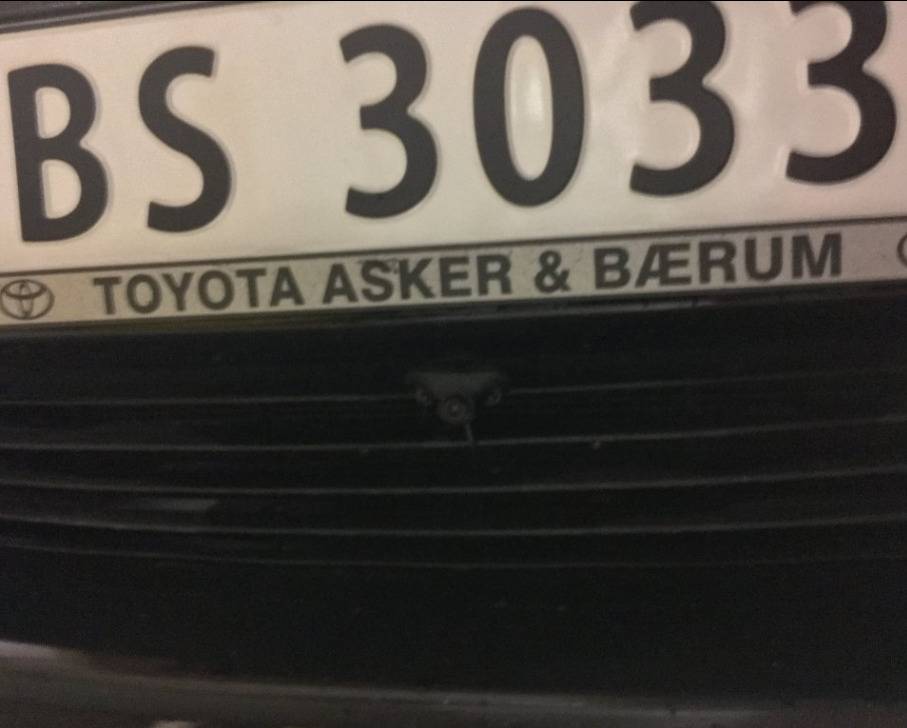

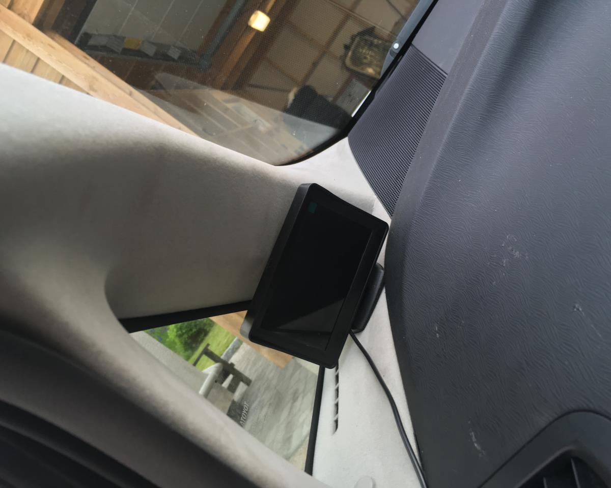

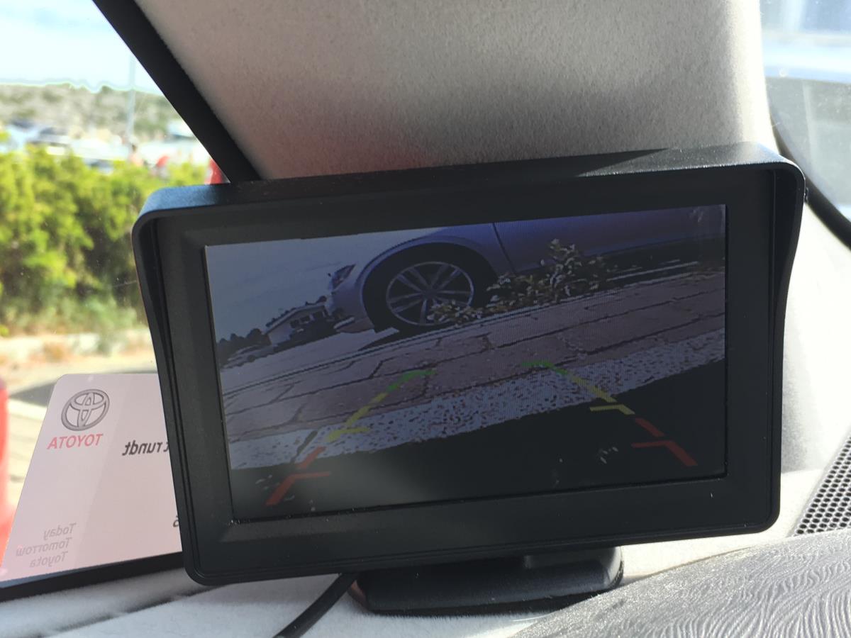

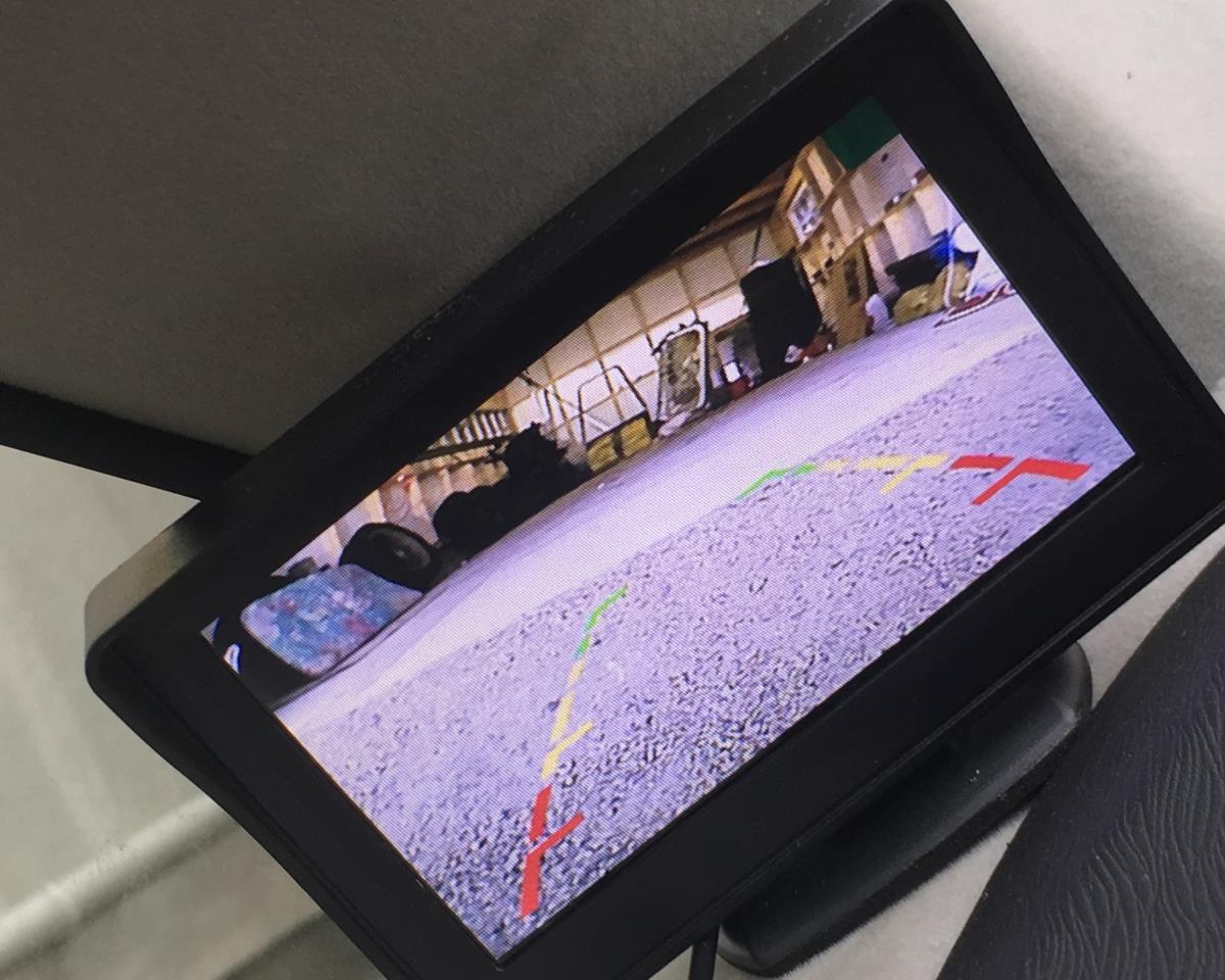

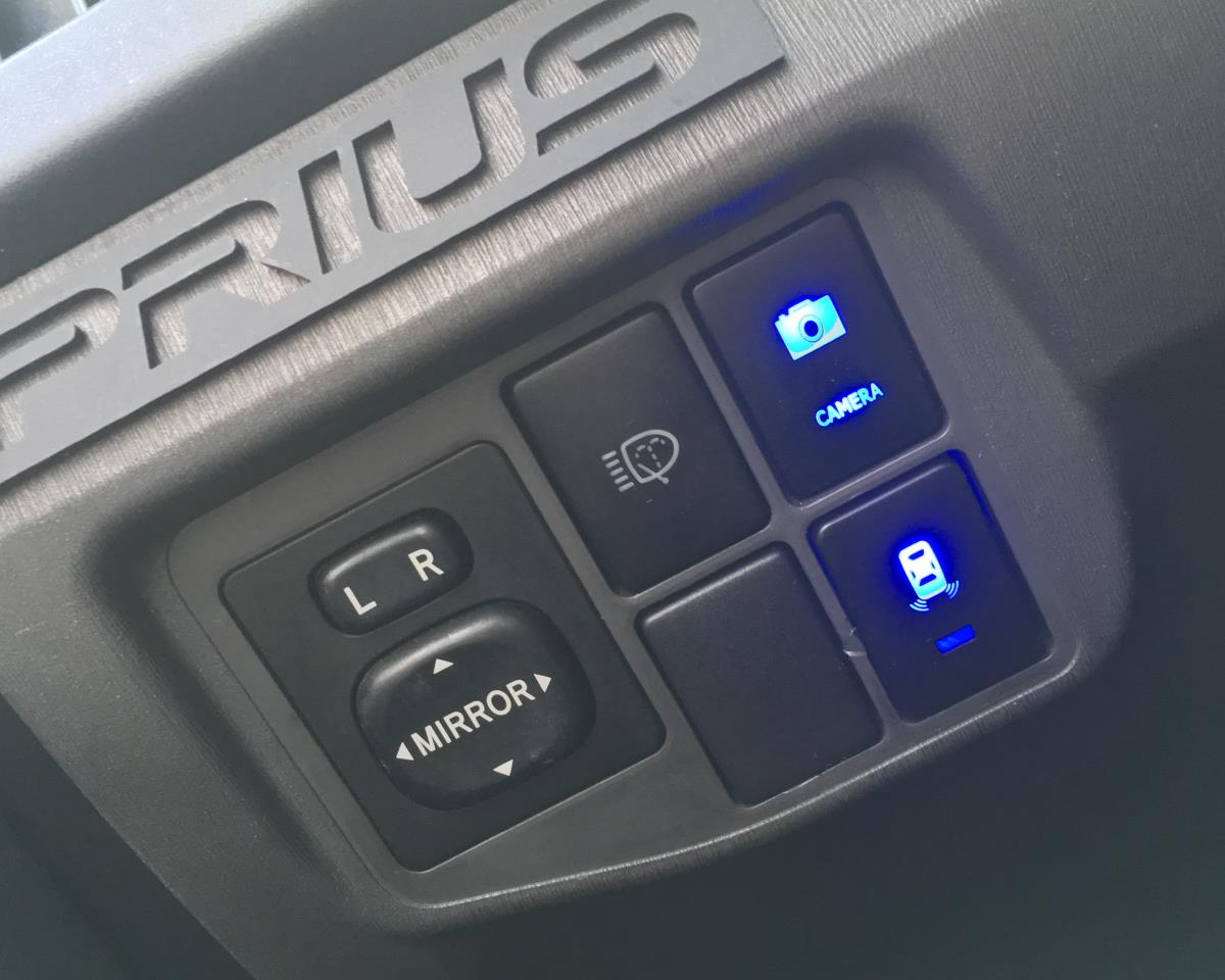

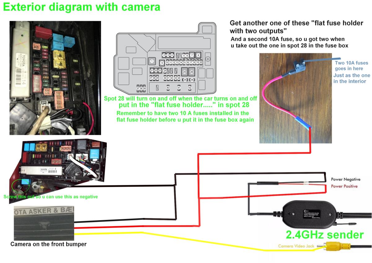

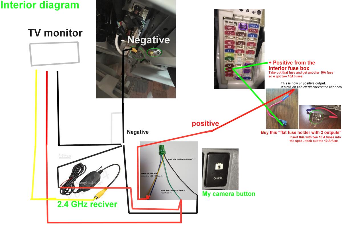

I already did this a while ago with both my Gen 3`s lol, Here is what i did, i dont got a gen 4 so i dont know if things r the same there, but here u can see what i did to my gen 3`s atleast. I was forced to buy a second camera since i got parking assist, like... the rear camera goes thru the parking assist unit. and no matter what u do the rear camera always got first priority for the navigation. but yea... this is what i did. Maybe u can use it as guidelines or some for ur gen 4
