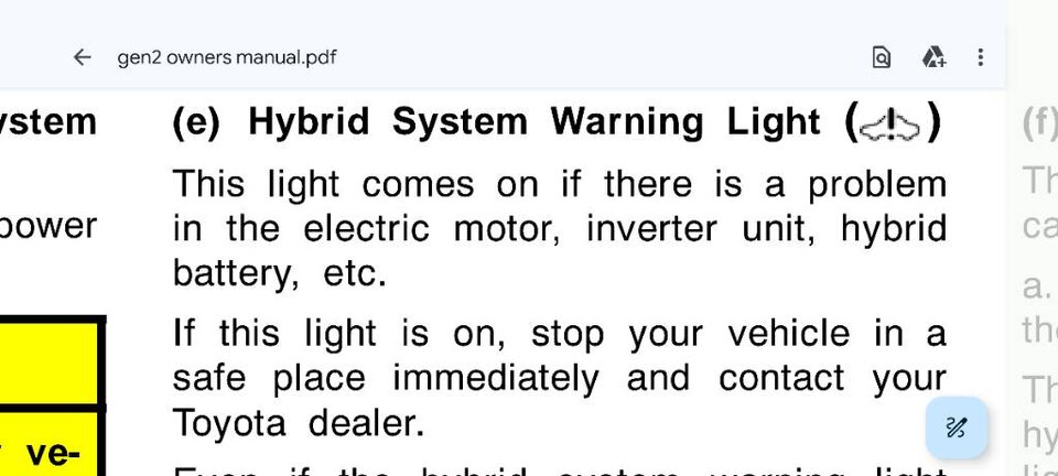

    The only information I have from the owner's manual is that icon indicates a fault with something in the hybrid drive system. Usually I would expect such a problem to trigger the "master caution" (red triangle) as well.
