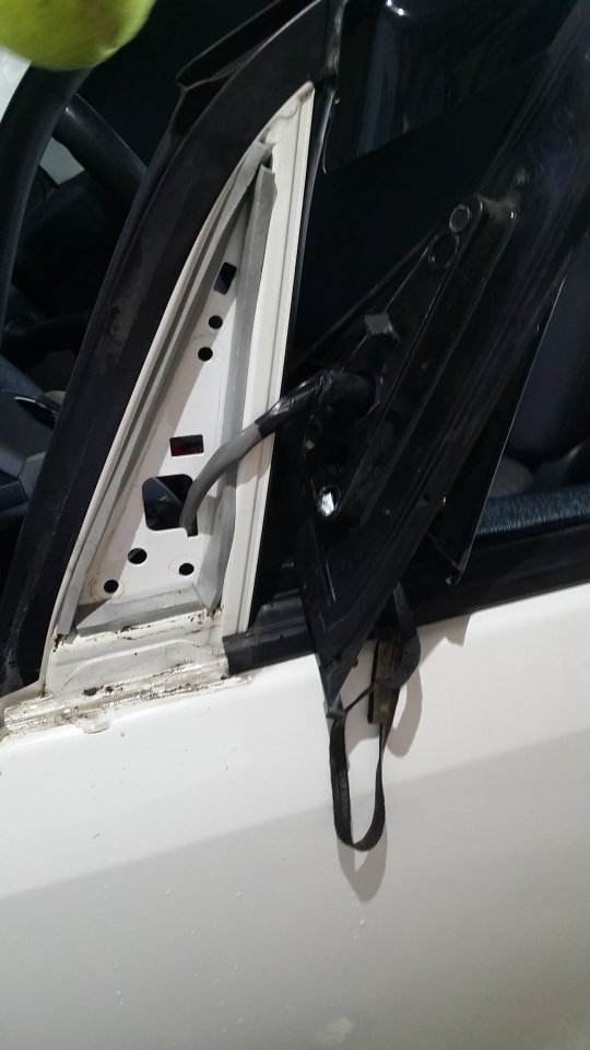

    Here are some pictures from my car. After much searching and finally coming across your post I think what I need is a window channel run. My question is, how many runs are needed per window. My drivers side window wont go up all the way as seen in the pictures because the rubber pinches and restricts the window from going all the way up, its getting worse everyday.
    Also would the drivers side be considered front left window?

    From left, one piece u-shaped, easy to replace.
