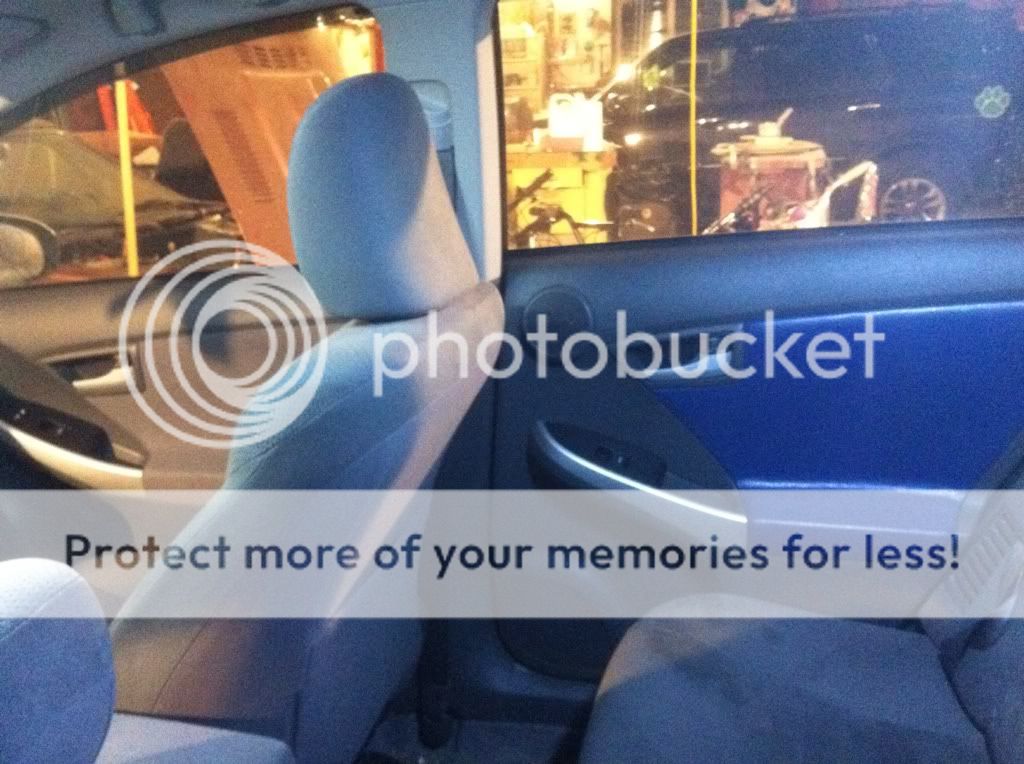

    Don't have enough to start my own thread, but wanted to contribute some pictures. Sorry if this is taken as a hijacking.
    My Album
  8. Tideland Prius
    45,176
    16,402
    Nice contrast!

    Nice. How do you re-attach the panels?
  10. Azimuth
    Azimuth Member
    Jun 8, 2009
    136
    32
    Austin
    I used the #8 Screws with washers as you specified.
