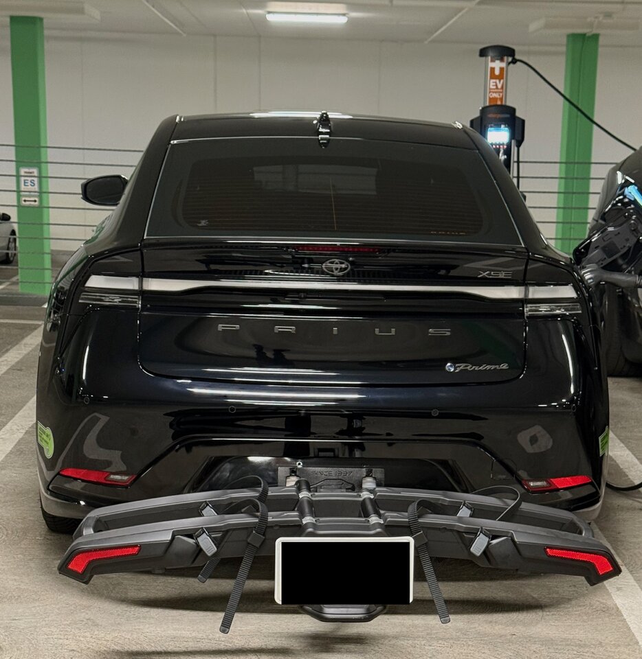

    Looking for feedback from those Gen 5 owners who’ve installed a hitch receiver (either 1.25” or 2”) and use a hitch bike rack. Type (hanging or platform/rack, tilt or not), make, model. Experience good or bad on scraping, hatch opening issues (if any) with bike(s) loaded, weight of rack, ease of install/remove, movement during travel, etc. Particularly interested in what @SXP has to say (1.25” receiver, 1Up rack – don’t know if a Quik Rack or Equip’D).

    I’ve never contemplated mounting anything off a hitch receiver on such a low ground clearance vehicle. I like the idea/design of the 1-bike 1Up Quik/Equip’D/HD, lightweight (under 30#), seems robust. Have seen a reddit user using a RockyMounts (looks like a Monorail 2 Inch but not sure).

    One thing about those (that drives me spare most every time I see them): how the heck are they even allowed on the road, when they obscure license plate, and likely brake/turn/reverse lights as well.
