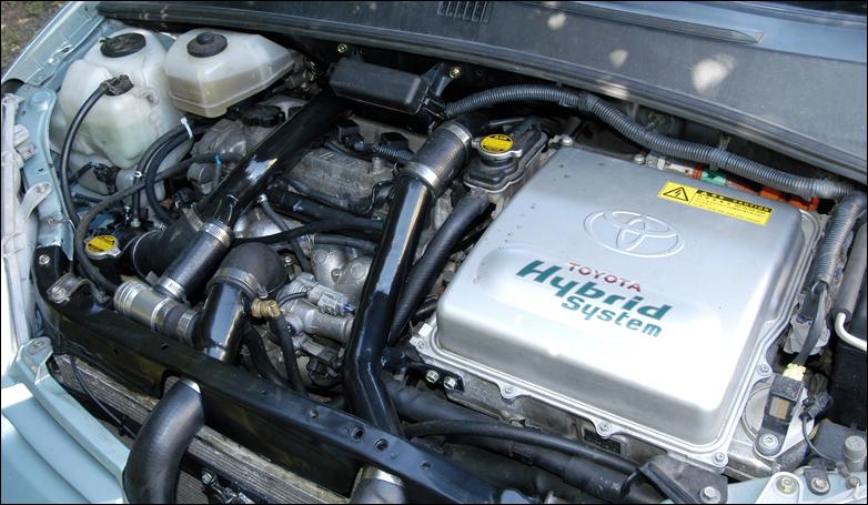

    Is this some kind of joke?

    24
    Vancouver, BC
    Yep. It's a joke. Someone probably bought a turbo decal from Autozone, and stuck it on there.

    The picture in question is from the Autospeed article on putting
    a turbo into a Classic. Julian Edgar actually did quite a bit
    of research and cut-n-try on that project, and the fun and
    frustrations are quite evident in the article series. Search
    for "turbo prius" over there for more of the story.
    It *did* seem to make improvements in an NHW10, and could feasibly
    have similar effects in a second-gen since the engines are
    virtually the same. In either, there's the Atkinson issue to
    think about, which changes the game.
