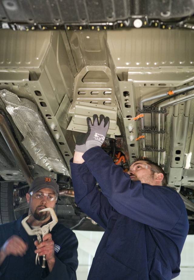

    Step 1. Shows that there already existed a brace and they are beefing it up (only 2-3 lbs total for all braces)
    BIG picture link of below: http://media.gm.com/content/Pages/n...ile.res/ChevroletVoltPartsInstallation115.jpg

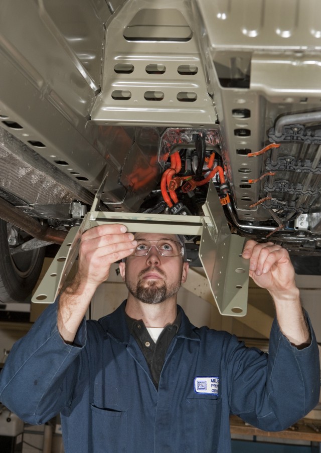

    Step 2. Notice brace from above is attached now.
    BIG picture link of below: http://media.gm.com/content/Pages/n...ile.res/ChevroletVoltPartsInstallation084.jpg

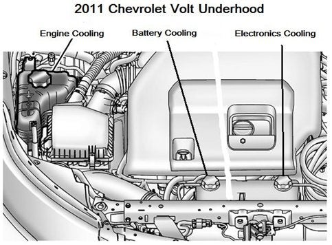

    I guess I do not understand the whole concept of cooling fluids in the battery. Isn't it a closed system? Normally, if fluid is boiled off and exits via a drain, when it cools down, would it not need to be replenished? Given the location of the battery, how would you add coolant?

    Yes, closed. You fill from under the hood. See this picture:
    The Chevrolet Volt Cooling/Heating Systems Explained
