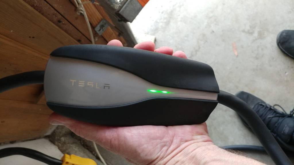

    to answer the OP's question, yes, charging 240v instead of 120v will be more than twice as fast.
    That said, if you use a Tesla Appliance, whether the HPWC or the car's UMC (comes w/the car) - those appliances will not allow your car to charge faster, even though the units can deliver more power than your plugin Prius can receive.

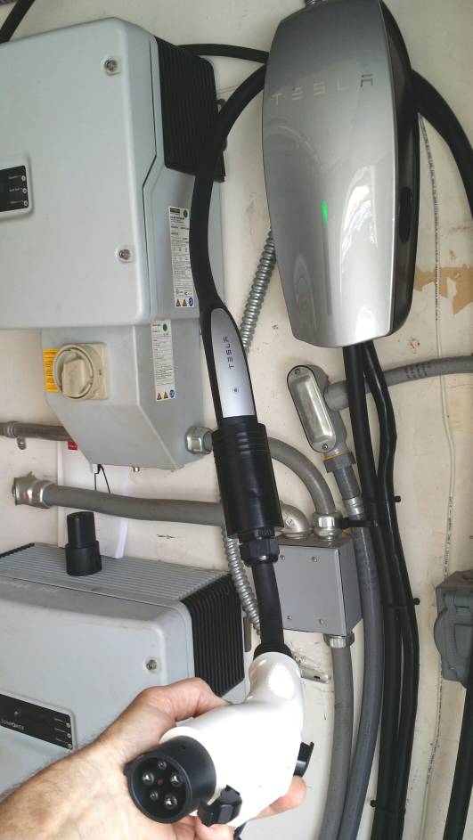

    Regardless of which Tesla Appliance you use, yes, you can use either to charge through the aftermarket Tesla to J plug adapter, which looks like this;

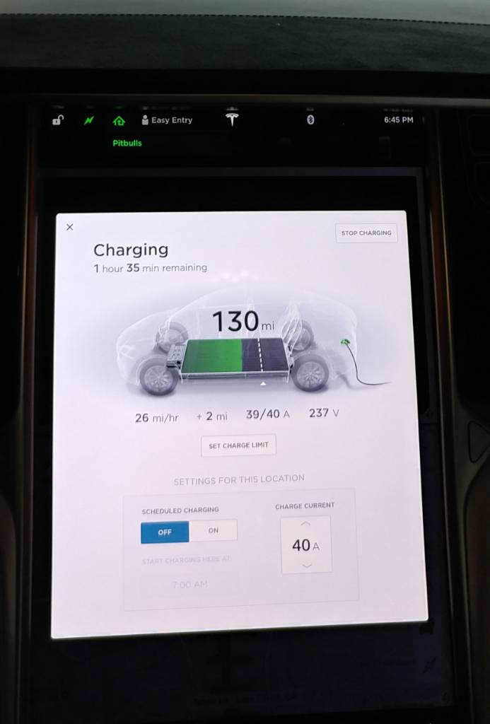

    Someone earlier said the model 3 could not pull this much, but here's a shot of the screen showing its capable of receiving 48 amps from a 240v source;
    That's a tad more than 11.5kW's. If you really need the full 48amps that the model 3 can receive, that would require the hpwc, rather than the portable unit that comes with the car.
    If you get a regular J plug charger, any one of several manufacturers, they typically Max at 40 amps. So you would only be losing a little less than 2KW capabillity over the Tesla hpwc (which, btw, can easily be reconfigured for 80amps - for some future use)
