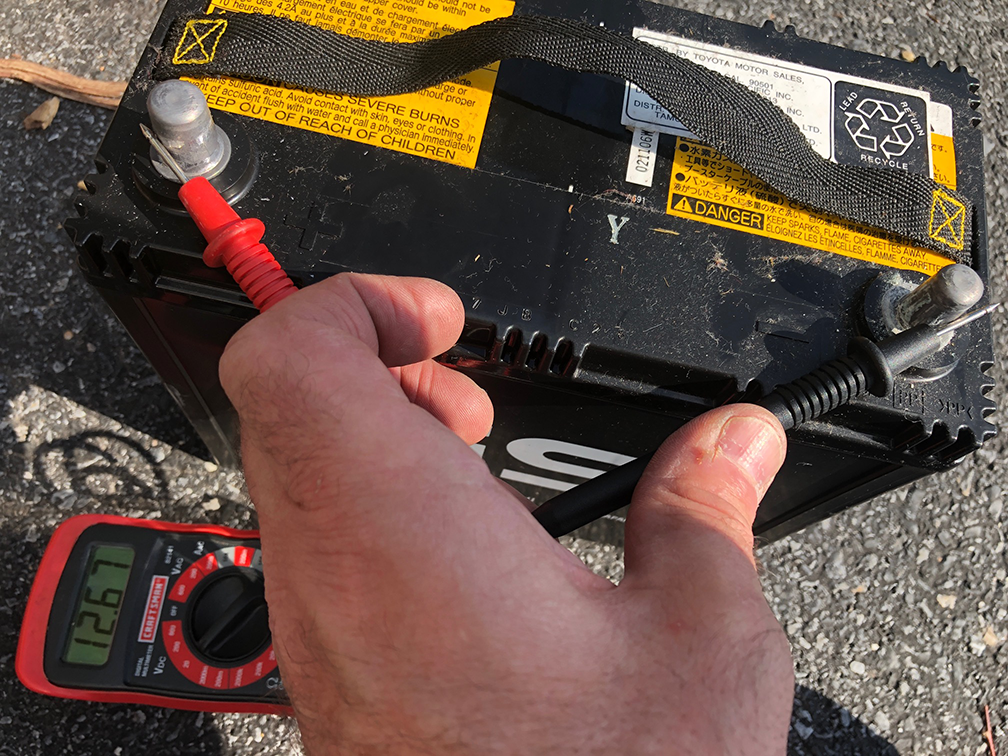

    My daughter's driving my 2007 now that I'm in a Prime. I'd never replaced the factory 12V. But now, with her away at school, I figured cheap insurance to put a fresh battery in, which I did yesterday. Curious how unusual this is - to have a full 12.67 across the terminals of a 10-year-old battery not under a load?

    That battery was in a well used daily driver?
    Hang onto it, charge it up with a smart charger every 3~4 months, if you've got the room, as a back up. If you want to check it's overall health, look into Solar BA5 or similar.

    Too bad you did not put a load in it (High beam, vent fan on high w/ no AC, radio on low), to see what the voltage would be.

    No maybe about it, it is fact, keeping a lead/acid full charged will keep it in top condition for a long time.
    ... with an automated maintenance cycle. You can then leave the battery on the charger indefinitely and the charger will switch on and off as required to keep the battery fully charged.
    It would have been nice to see what the voltage was with a load on it, but on the face of it, that battery did not need replacing. With your daughter away, is the car just sitting, or is it still being driven regularly? If it is just sitting, you might consider keeping the 12 V battery on a maintenance charger just so it stays in top condition.
