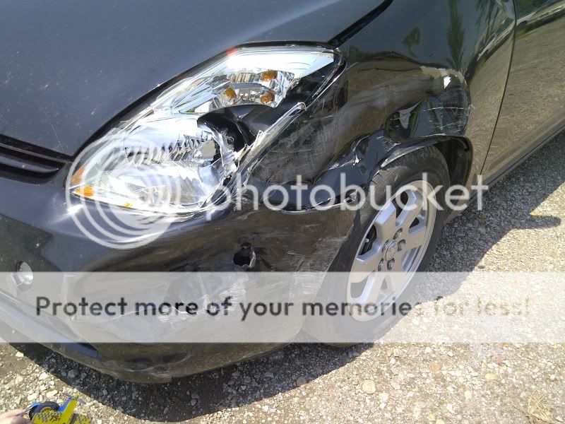

    Hey all.
    This happened the other day
    I'm wondering, do I need to take it to a Toyota dealership, or will any reputable body shop be okay? I don't think anything engine/battery/hybrid systems was damaged, but you never know...

    That'll buff right out!
    Don't go through the dealership. Call your insurance agent pronto. Good luck. :)

    Are you seeing a pic? I'm at work, could be some filter is hiding his link?
  5. macmaster05
    macmaster05 Senor Member
    Sep 27, 2009
    4,050
    730
    There's a pic indeed Mendel. In case you wanted to see it here's the link:
    [ame]http://img.photobucket.com/albums/v505/coalesce99/IMG-20110529-000321.jpg[/ame]

    If you are going through insurance, and there is ANY sign that the coolant thermos was damaged, insist that it be replaced.

    I would say it is likely that the coolant canister was damaged. This is part of the engine cooling system.
    The body shop likely will not be competent to replace the coolant canister because a special process is required to run the coolant heat recovery system pump when filling it. Hence I suggest that the OP should ensure that the repair estimate includes outsourcing that piece of the repair process to a local Toyota dealer.

    New info -- my wife said it looked to her like something leaked onto the wheel...
    Onto the metallic disc behind the wheel --
    Significant?

    Three possible fluid sources that might be leaking on the left front brake rotor:
    1. Left front strut is leaking strut hydraulic fluid
    2. Left front flexible brake hose is leaking brake fluid
    3. Coolant heat recovery canister is leaking engine coolant
    If the fluid has a yellowish oily color then it is 1 or 2. If the fluid feels weird when you touch it (like it is sucking moisture out of your skin) then it is 2. Brake fluid is hydrophilic and absorbs water. It also will damage paint.
    If the fluid is pink then it is engine coolant.

    Wife says it was a "brownish rust color" so I'm thinking it was 1 or 2

    The dealer is evaluating today. I asked, and the coolant cannister is "crushed." Over a $1000 part :)
