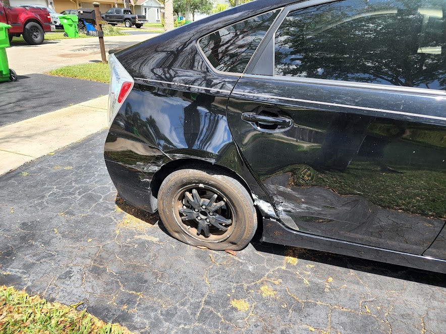

Had an accident my 2013 Prius needs to be towed lifting the back ?

    Is there a specific way it needs to be towed in order to not damage the vehicle ?

    16,632
    8,492
    put a new tire on there or add some air. Then ask for a flat bed tow truck

    IF.....that is the only damage, put on a new tire and drive it to the shop.
    IF......it really needs to be towed with no access to the front for the wrecker, then yes they either put the car in Neutral if it "runs" or they jack up the front and use dollies to get it out into the street.

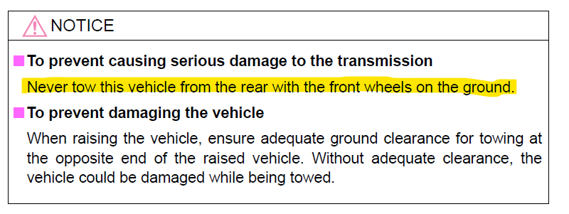

  6. CR94
    CR94 Senior Member
    Dec 2, 2014
    2,658
    1,147
    Northwestern S.C.
    The owner's manual warns not to tow backwards (even in neutral) with front wheels on the ground.

  10. tak1313
    tak1313 Member
    Apr 7, 2016
    37
    MA
    Towing instructions from the manual. That's not to say you can't at least MOVE the car backwards for the sake of access/positioning.

    So the original guy that towed the vehicle to my house from the accident scene said he owns 2 Prius and said the car needs to be in neutral to tow it. Then he strap tied something inside the cars steering wheel to stop the steering wheel from moving put the car in neutral and lifted the back and towed it to my house pulling it from behind. When it got towed from my house to the body shop they used a flatbed .
    Do you think this damaged my tranny and how will I know ?
    How do you think i should to handle it should i tell the claims adjuster?
    The original tow from the accident scene was not connected to my insurance it was just some random tow company I googled and called.

  12. tak1313
    tak1313 Member
    Apr 7, 2016
    37
    MA
    I don't see anything about being able to tow from the rear if in neutral. You may want to call your local dealer to discuss the matter and what the ramifications are (if any).
    EDIT - forgot to mention, as the Prius does not have a torque converter (it uses a variation of a CVT), there is no "slip" as would be allowed in an old style transmission with a torque converter - plus the fact that the transmission has some pretty sensitive stuff related to the hybrid system.

  14. douglasjre
    douglasjre Senior Member
    Sep 13, 2008
    2,062
    691
    Null, NL
    ----USA----
    CVT WS fluid pumps when wheels rotate forward
  15. douglasjre
    Sep 13, 2008
    2,062
    691
    Null, NL
    ----USA----
    Car looks totalled anyway. Won't matter unless u do like we do in NY and body fill it til it looks like a cab
