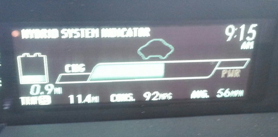

    Here is my blended mode trip today.
    I left the gas station with 11.0 EV range and 0 miles on the Trip B. I went about .7 miles before hitting the freeway. I entered the freeway and hit CC at 65mph (66mph displayed) with about 8.7miles EV range displayed. I was kicked out of EV Blended Mode at 12.5 miles total. I took the picture before being kicked out. image.jpg

    The crappy part is in blended mode with a cold engine, the iMPG drops to around 38-44mpg while the engine warms up from about 100F to about 130F. Then it jumps up to 98-110mpg or so until it hits 193F at which point it does another cycle check and iMPG drops to 55-60mpg then jumps back up to 98-110mpg until EV range runs out.

    Good info, thanks Justin.
