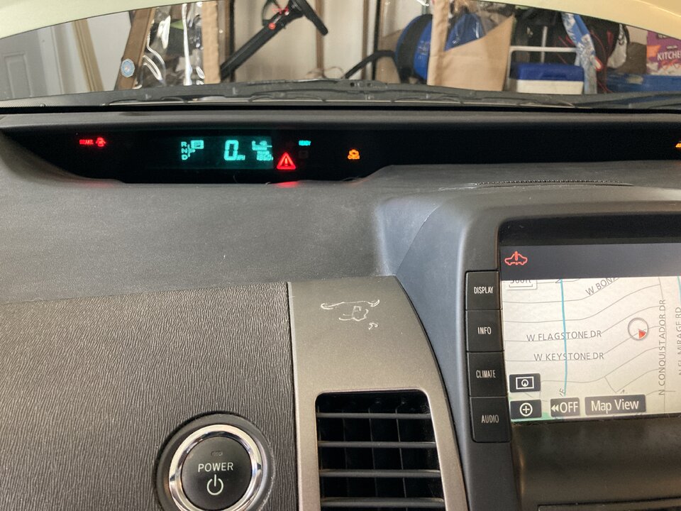

    After cooling down, the VCS light is off, the car light on the right of the dashboard is still orange, and the triangle still red.There is a red car with a vertical line in it on the center display.
    There are no Menard’s here, sadly, my neighbor also misses them. The 2 local auto parts stores I called do not have any device to check error codes on my Prius, but there’s a possibility Pepboys may. I don’t want to go to the dealers unless I really have to, but they are about 10-15 miles away. My hubby will check the fuses tomorrow. IMG_2822.JPG

    No idea. Without a scantool that can check all systems for codes, you have no idea either. All you know is that the Hybrid Control ecu detected at least one of many dozens of faults that caused it to turn the warning lights on
    Maybe it can make it, maybe it can't.
    You can turn the car on to "ready" mode, then remove the cap of the inverter coolant tank (the one in front of the driver's side - under the hood). Look inside to see if coolant is moving around or is still.
    IF the pump is dead I wouldn't think you can go too far in hot weather, - A/C use, high speed or load will cause "overheat" sooner.

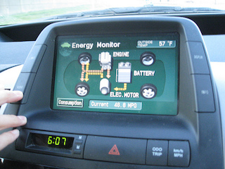

    You can certainly get whatever trouble code is behind the VSC light, without having to wait for access to a scan tool. Just get it this way: Blink (a/k/a Flash) Codes – How to. | PriusChat
    Sadly, that way doesn't work for the trouble codes behind the triangle light. And it's possible the only VSC code will be 51 (which only means "go pay attention to the codes behind the triangle light"), but even then you'll know more than you did.
    If you end up wondering just what Tom's going on about there, it's a little visual pun that can happen if you normally drive around with the Energy Monitor screen showing. That screen happens to have a green car in the top left corner, just as part of its artwork.
    [​IMG][​IMG]
    When you get the triangle light, you also get a little red car-exclamation-point that overdraws the top of the display, covering part of whatever screen you're viewing at the time:
    [​IMG][​IMG]
    So if the Energy Monitor screen was the one you had up, with its little green car in the corner, then when the red-car problem symbol is overdrawn on the display, it can look like "the little green car turned red" if you're not paying much attention.
    The problem symbol, though, doesn't tell you anything more than the triangle light does. They both only mean you need the trouble codes to know what's being reported. Neither one is specific to the inverter pump, or anything else.

    It's funny the way everybody else can plainly see in the photos how the car-exclamation symbol is drawn over top of the underlying screen display, even cutting parts of letters and other symbols off.

    Seeing the car-exclamation point and the covering of the screen sorta helped me realize this was a serious issue, since it did cover part of the info screen. Sorta like if your mom calls you by your first AND middle name, you know it’s trouble. haha! The error code for my Prius is pao80, so am taking it in to a service shop that comes recommended. It’s about 20 miles away, with avoiding the highway about an hour drive. Hoping it will limp along that far!
