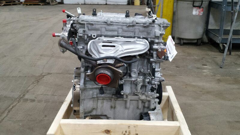

    We noticed this in our car for a while, but now haven't had in all winter. It was when we would start the car in the morning to let it warm up. When we got it it would smell like exhaust. But I think we have a bad exhaust manifold gasket or it's cracked. Upon acceleration, when cold, I can hear exhaust sounds. I can't see a problem anywhere else in the exhaust system. Once it warms up the noise is reduced. I had the same things happening with my old civic and I could see the cracks. Anyone know if the exhaust manifold would come on a used engine? I could never get a used replacement for the civic because it had a cat built into it and salvage had to recycle them when they came in.
    Is that the exhaust manifold in the front of the engine in this pic?

  15. Mendel Leisk
    Mendel Leisk Senior Member
    58,434
    40,236
    Don't quite understand the question, apologies if I'm missing something, but that's rear view of the 3rd gen engine.
  16. climb.on
    climb.on Junior Member
    Dec 27, 2010
    30
    18
    MN
    Three Touring
    Correct. This is the rear of the 3rd gen engine. Is the exhaust manifold the part with the large red cap, between the block and the photographer?
    This is a pic of a used engine for sale locally. If it includes the exhaust manifold, it would be a bonus, because I believe mine is cracked.

  18. Mendel Leisk
    58,434
    40,236
    It's also got the EGR cooler, a plus:
