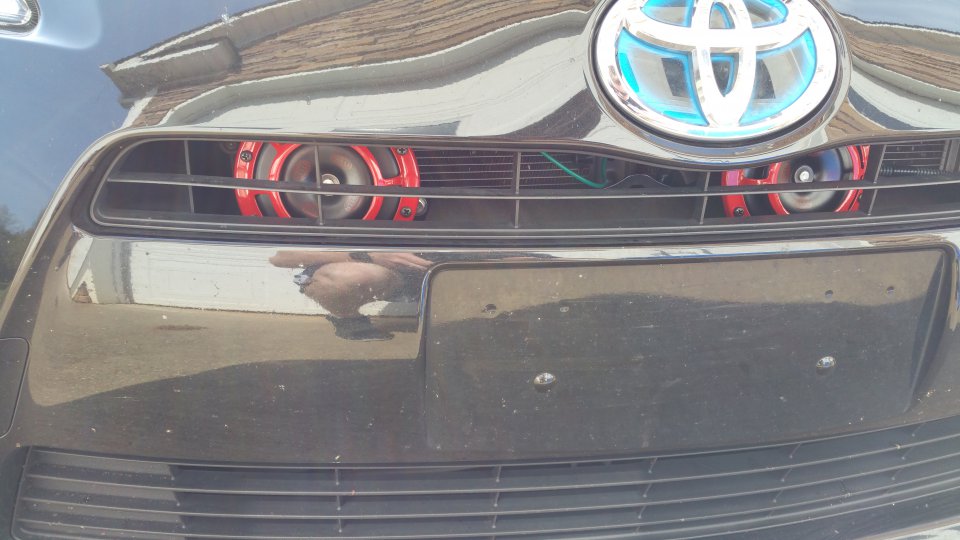

    I think we all know our stock horns are junk. I cannot count how many times I've had people almost run me off the road because they can't see or hear me. Today I installed the Hella supertones. As you can see in the picture I posted there are perfect mounting holes in the chassis behind the grill for both horns. I grounded the new horns to the old horn mounting bolt.
    I can get get into more details if you like and more pictures as well. There is enough room down there for another set of horns. I'm very tempted to add them.
    All in all with the stock horn removed and the Supertones installed, my C is a screaming machine when I mash the horn. I am very pleased with the sound and loudness.

    I figured why not just add the relay that came with the Supertones. It may or may not have made a difference right now but if I go forward with installing an additional pair for a total of 4 horns then I'll be glad I have the relay.
    Plus with the current set up I have, I didn't have to modify the factory harness to accommodate the 2nd horn.
    When the rain stops I'll post some install pictures and a video of the horn sound.

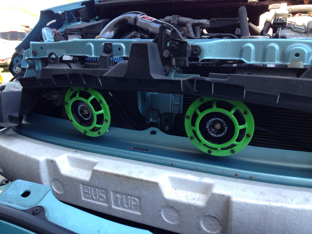

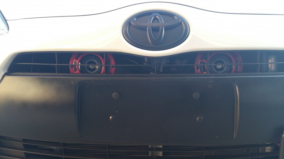

  8. yOsHi LiN
    yOsHi LiN Active Member
    May 12, 2014
    215
    138
    los angeles
    2014 Prius c
    i did the same but sickspeed !!! i dont like how it sound but just the look !!!
  9. SamanthaC0716
    SamanthaC0716 Active Member
    Mar 12, 2014
    333
    115
    2013 Prius c
    I have Sickspeed horns sitting in my garage, waiting to be installed. Why don't you like how they sound? Are they not louder than stock?

  11. yOsHi LiN
    May 12, 2014
    215
    138
    los angeles
    2014 Prius c
    yeah they are louder, but who really uses the horn
  12. yOsHi LiN
    May 12, 2014
    215
    138
    los angeles
    2014 Prius c
    yeah they are dual tone, but it kinda sound like a go kart
  13. SamanthaC0716
    Mar 12, 2014
    333
    115
    2013 Prius c
    Mine are in. I'd recommend the Sickspeed. I like how they look and sound. (They don't come green. I painted them that color.)
