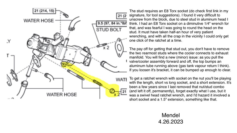

    Even Mendel will admit to leaving off mounting studs to make reinstallation and subsequent "cleanings" much easier.
    Prius gen3 egr stud removal.jpeg Some have cut off brackets, some drop gaskets and reinstall the egr cooler or valve without a gasket only to CAUSE a rough idle they did not have before. No problem, just do it again.

    Anyway, why not leave both the stud and nut off? It expedites removal big time, by:
    1. no longer needing to deal with it, access being difficult
    2. negates the need to remove the rearmost studs (at connection to exhaust manifold) which in turn means the gasket at that connection is retained by the studs when you pull the cooler forward and out.
    Not mentioned in your cut-and-paste of my previous posting, but an E6 socket is needed to back the stud out. And some wrestling cables and brackets out of the way. I used a diminutive 1/4" ratchet, and it took maybe 15 sweaty minutes, one stubborn click at a time, to get the damn thing out.
