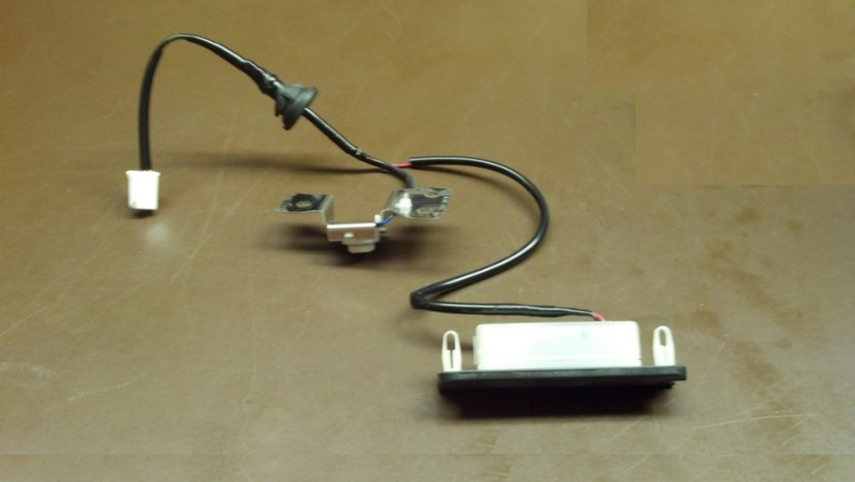

  4. FrankD

    Thank you SO MUCH for this info! I am currently up here in Freezing NY, so when I get back to sunny warm Florida next week I will look into this. You are correct....this switch cover IS all melted. Perhaps this is just a fluke that this happened when we got up here...I was hoping it is just frozen and it would start working again when I got back south....but the switch does seem like it does not move at all.
    I really need this to work, as I now use this car for my Home Inspection business and keep all of my ladders and tools in the back. So.....maybe I can get my dealer to fix this. If not, because this forum saved the day again worse case I can fix this myself. Any additional info is appreciated....I will keep you all posted!! Thanks, Frank D.

    Hope the PB Blaster works. If they don't reasonably come off, here is a pdf on how to replace the switch with a splice.
