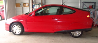

    OK this is what happened. Friday I went out to my garage and instead of finding my Prius.......
    I found this.........
    Looks like my Prius shrunk to a Two seater. :mad: :D
    Actually I bought myself a 2000 Honda Insight. Has 126K miles and I got it for $5700. After getting it home I found it gave a P1449 code which means it needs a hybrid battery. It also has some chipped paint and scratches other than that it still runs good.
    Personally I knew that I was buying a car that may need some fixing up and a rebuilt battery is only going to cost about $1200. I dont mind because the car can still be driven like a normal non hybrid and I still think I got a pretty good deal for it being a rare high MPG car.
    I still have and will keep my Prius. :D

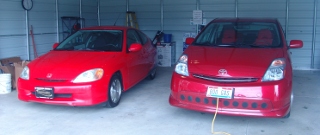

  10. kenmce
    kenmce High Voltage Member
    May 4, 2004
    1,543
    514
    NY
    What is that line of black circles on the chin of the Prius?
  11. TonyPSchaefer
    May 11, 2004
    14,816
    2,499
    66
    Far-North Chicagoland
    That is a cover for the lower grill. The circles are holes cut into the cover. Depending on the ambient temperature, he can plug some or all of the holes for a partial or complete grill block.
