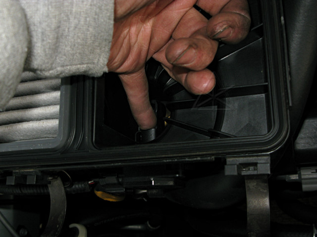

    down in there. The sensor is VERY touchy about airflow, though.
    Today I let the engine idle [y'all remember how to do that, right?
    See the Georgia inspection threads] and with the air box cover
    open, simply stuck my finger down over the MAF opening that
    leads into the hot wires:
    Even before my finger got there and was just waving near the
    sensor, the engine note started to change. Once I mostly blocked
    the opening, the engine promptly sputtered and died. So the
    MAF is very key to having it run right, and very sensitive to
    any sort of disturbance. The MAF assembly only samples some
    fixed fraction of the total air flow, so variations in what it
    sees will likely create a more profoundly distorted picture of
    how much fuel to inject.
    So if you play in that side of the air box, keep it very very
    clean! I would have really liked to see what the Toyota guys
    found that afternoon.
    Interestingly, when the engine died in Neutral no warnings
    came up. I guess the car doesn't care what happens to it in
    that state, it only cares when the hybrid ECU has control of
    things and the engine misbehaves.
    _H*

    Great experiment. Note that DTC P0101 "Mass or Volume Air Flow Circuit Range/Performance Problem" is likely the DTC that would be triggered by your finger blocking airflow into the mass air flow sensor. This DTC has "two trip detection" logic, so the problem has to happen 2x before the DTC will be reported by the engine ECU.
    It is also interesting to note that this DTC does not allow a fail-safe condition that would allow the car to "limp" home. So if the MAF sensor starts to produce bogus results, the engine will just die as you and the subject of your original post discovered.
