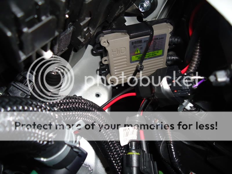

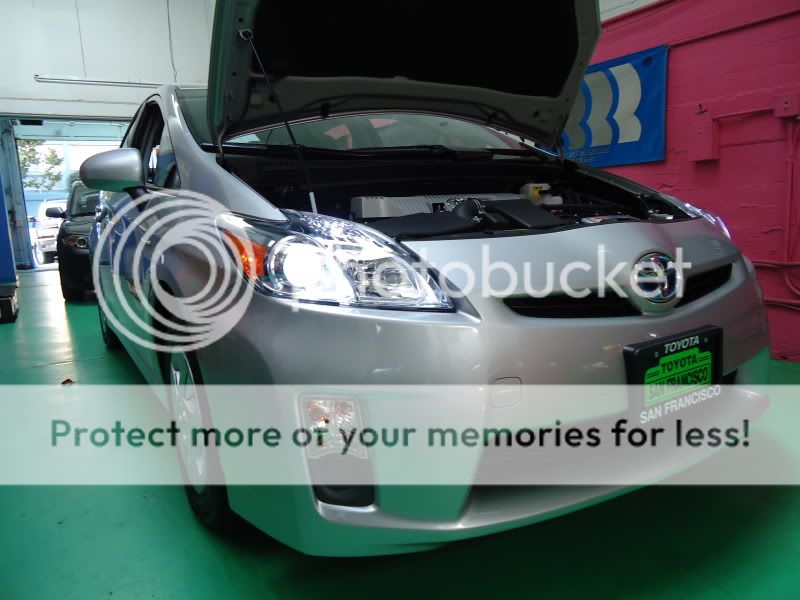

    I have just installed my new HID headlights today, here are some pics :)

    Very nice. Been thinking about doing the same mod on my 2010 III. Done lots of audio upgrades and mods, but never HID's. Which HID kit do you recommend? did you do both hi and low beams or just low? Any words of advice would be appreciated.

    ^^ Any HID kit is pretty much the same. Where you buy is what matters if you want a warranty. I have always done just the low beans on my car as the lights take time to warm up so unless you're doing extended driving with your high beams, its not really worth it. I also recommend a relay so that the kit pulls power directly from the battery and uses the stock wiring only as a switch for the circuit so you don't increase the risk of melting your OEM harnesses due to the increase initial draw of power needed to ignite the gas in the bulbs.

    if you guys are interested, my shop sells this HID kit for 120 shipped, it has a flat ballast and customers from my shop who has installed that kit never had the overheating problem, you can pm me. :)
    i agree andino, I only did my low beams, High beams i rarely use, since i'm mostly in downtown San Francisco.
