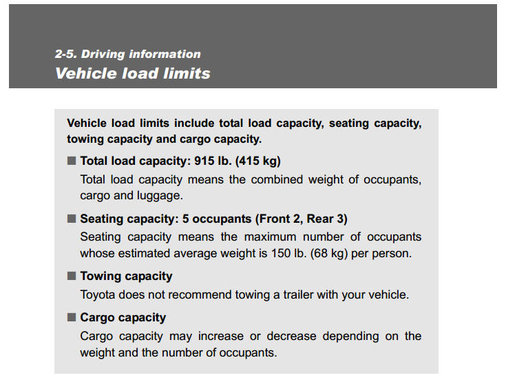

    Yes you can get a hitch for a Prius v. Quite a few have done it and there is some consensus that short trips that exclude mountain passes in a properly loaded vehicle would not cause a problem. In fact the video below shows one being installed on a 2012 Prius v.
    There has been lots of debate about Toyota's recommendation not to install a hitch. The usual issues: 1. Total vehicle loading should be limited to 915 lbs which includes passengers and cargo. Possible downside - have to substitute the chair for Aunt Blabby 2. Towing over long mountain uphills "could" exhaust the HV battery, which then limits the car to the 1.8 liter engine. Possible downside: slower speeds on long uphills. 3. Descending long mountain stretches with a heavy load could quickly fill your regenerative storage capacity forcing you to (gasp) use engine braking (the B position) and the brakes. Possible downside: slower speeds on the some downhills and increased brake wear. 4. "Could" void the warranty, if you still have one. Possible downside: You have to wait until the warranty expires or take a chance. Some have said that Federal law prohibits a manufacturer from voiding a warranty on unrelated items.

    Prius v Load Capacity and Towing Recommendation:
