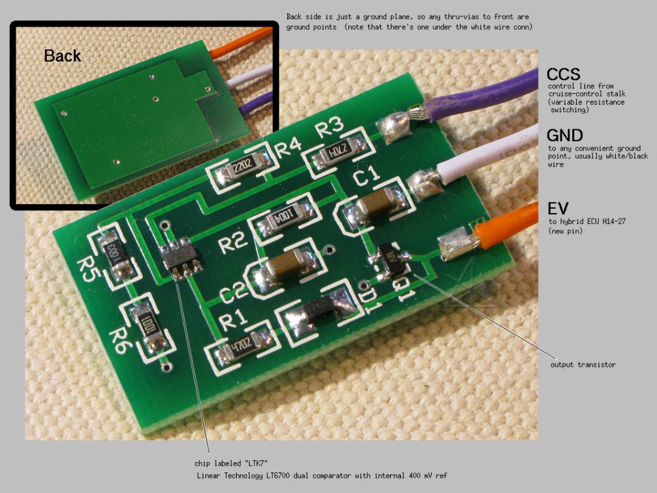

    I'm trying to decide how I want to do an ev mod. Having an engineering degree, I hate spending money on something I can build myself. I like the idea behind the coastal ev mod as I find it a clean mod (no extra buttons, or running wires across the dash). Has anyone attempted? I found this pic of the circuit with the heatshrink removed. Doesn't seem too hard. Thoughts?
