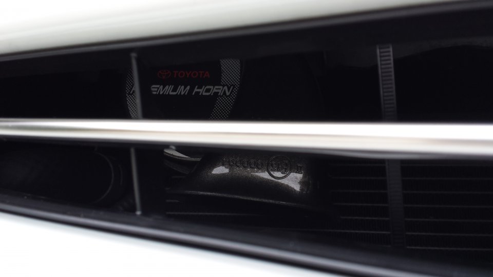

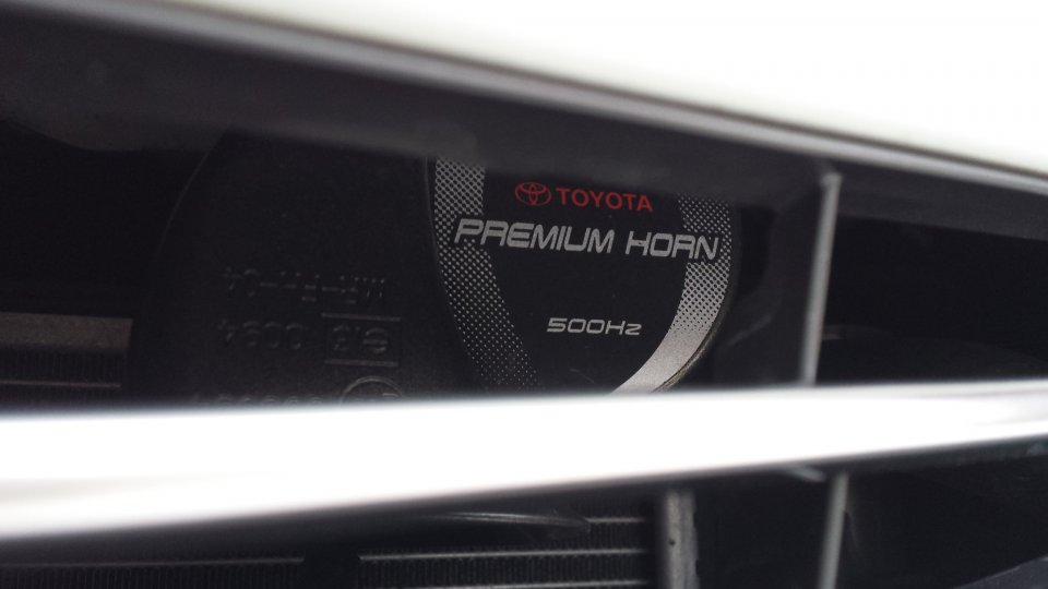

    Installed JDM Toyota Premium OEM horns from Japan. Quality is awesome.
