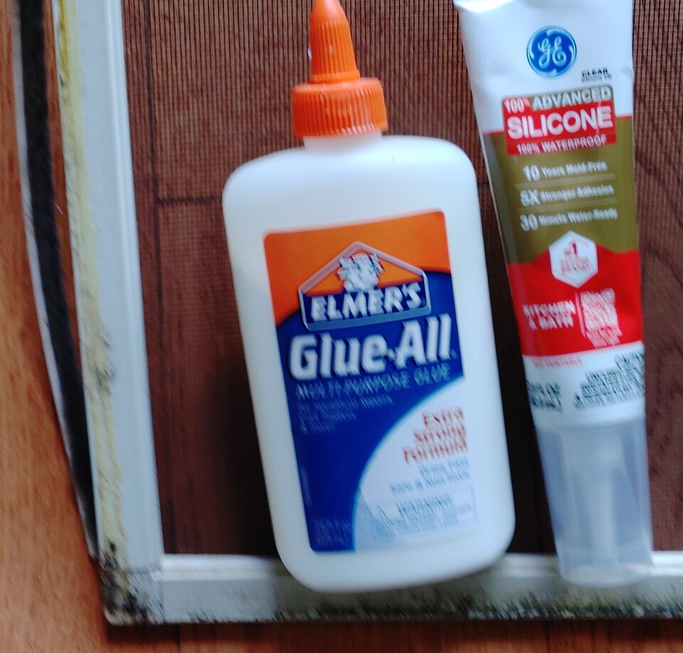

    I was "DOGED" and while looking for gainful employment am taking on some long overdue home chores.
    Found the woven synthetic weatherstrip that is glued to the window screen frame is coming off. I may have fixed this a few years ago. If so, I can't recall.
    Any tips on what adhesive I should use? I included the only two I have on hand in the photo.

    Like this stuff?
    https://www.lowes.com/pd/Prime-Line-18-ft-x-3-16-in-Gray-Felt-Door-Weatherstrip/5014891229
    I would replace it with new material, or use contact/rubber cement, possibly?
    Contact/rubber cement is applied to both surfaces and allowed to dry, which doesn't take long, as it is solvent based. Then, when the pieces are pressed together, it forms a really strong bond.
    Those other two adhesives/glues are applied wet, and need to be held in place (usually clamped) somehow till they are dry.
