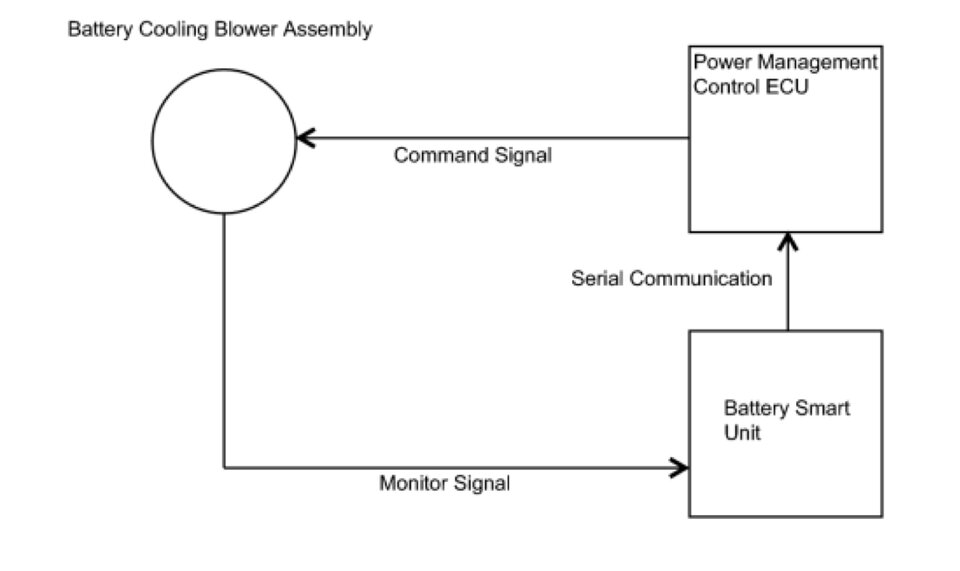

  4. SFO
    SFO Senior Member
    Feb 7, 2017
    5,302
    4,244
    Northern California

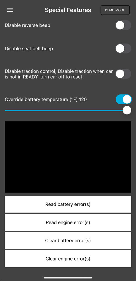

  10. George W
    George W Senior Member
    Mar 12, 2018
    911
    514
    San Antonio
    In the Dr. Prius app, under Special Features, you can over ride the temperature settings ( force the fan to start at a lower temp).
