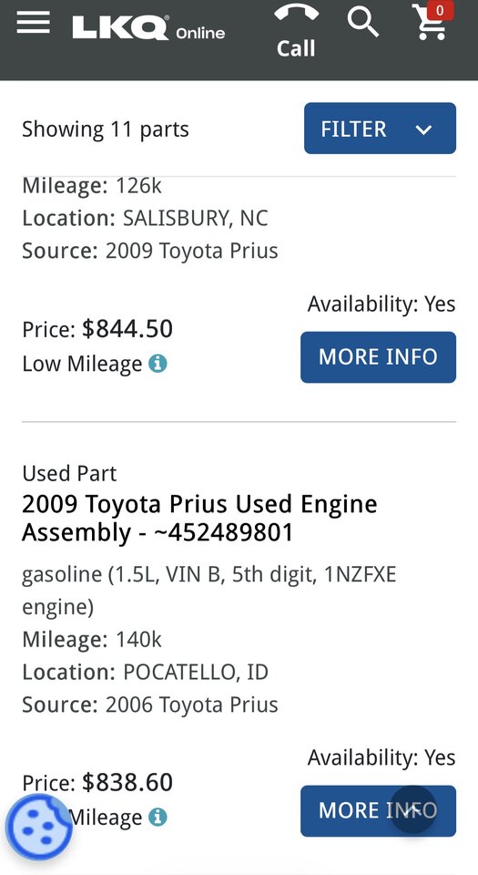

    Several have suggested a replacement engine assuming coolant is and has been in the oil. I would add, get a replacement only if the car is very nice and the hybrid battery and brake booster are good. Engine replacement is the logical choice under this "assumed" scenario.
    LKQ provides engines with donor car information that can be trusted. You might live close to one but we don't know. You might be in Alaska.
    2 of 11 LKQ "Low Mile" Engines for an 09 Prius
