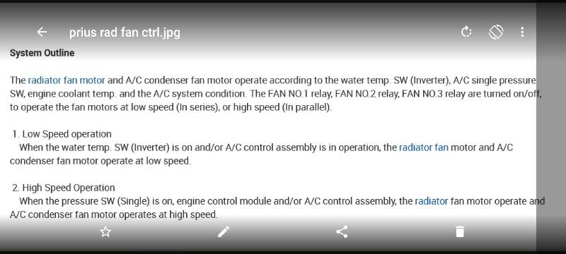

    If you turn the A/C system on, both radiator fans should come on "low" speed (fairly quiet). If A/C system pressure goes too high or ICE coolant temperature gets hot, then both fans turn on "high" speed (pretty loud).
    If one fan doesn't work, then low speed is inoperative (both fans are connected in series). On high speed they are connected in parallel to full "12V" power (so one can work even if the other is bad).
    In Techstream you have to go into ECM tests to use the bidirectional command & activate the high speed fans. You have to go into HVAC tests to activate low speed fan operation. Screenshot_20230719-124727.jpeg
