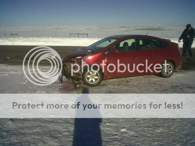

    I guess I really want someone to tell me they will repair it. My husband was turning this morning and a pickup decided to ignore his turn signal and attempt to pass. By the time the pickup realized my husband was turning it was too late and my Prius was the casualty! Can you guys give me your guess on whether my baby is totaled?
    I live in Rural MT, the accident happened at 9:30 and HP isn't even on scene yet, so who knows how long it'll be before we hear from insurance!

    Hope your husband is OK.
    If the front air bags deployed, then I would say it is likely the car will be totaled.

    My hubby and our dog are both okay. he says they barely felt the impact. He was truly impressed with the Prius' safety. The airbags did not deploy at all. He said if he was holding a cup of coffee it wouldn't have spilt even though the pickup was traveling at approximately 70mph. He said it was just like the front of the car broke away.

    I see pink fluid.. Indicative of the transaxle being damaged perhaps. I hear that's quite an expensive repair just by itself. Doesn't seem like a front end collision as well, so probably why the airbags did not deploy.

    Yikes! That hit is on the inverter side of the car. If that was damaged (looks like it might have been given that big puddle of coolant), that plus the body work probably totaled the car. I'm really sorry for your loss.

    The front wheel doesn't look like it's turned rather canted at an angle. If so, that's definitely not good.

    Thanks guys. Not what I wanted to hear, but kinda what I figured. Now the fun part. Insurance Adjusters!

    I think the rule of thumb is if the salvage value (how much a wrecker would pay for it) plus estimated cost of repairs is more than current value (what it would sell for on a used car lot), it's a write-off. Maybe someone else can comment, I'm a bit fuzzy on that.

    It is possible only the hood ,fenders and bumper cover was damaged. The suspension does not appear to be damaged and there is no fluid on the road. It maybe just cosmetic? Hal

    Are we looking at the same picture? I believe that's the coolant "thermos" laying on the ground (in a puddle of coolant)...

    Yes you are correct. I did not see that or the pink snow. SSSSh Hal

    looks cosmetic.

    The pink is probably because there doesn't appear to be a coolant heat recovery tank anymore... just gone along with it's pump etc... so the transaxle may still be ok. The tank etc will be a bit expensive but not tranny expensive. I also see you're now missing a trim ring so that makes it look a bit better :)

    I just got my car back after being hit on around new years. I needed both driver side doors, new windows, new mirror, plus a new fender and quarter panel. total was 6g in damage but my car is an 04 with 85k and laoded, gps, cd changer, jbl. If it was a base model with over 100k it would have been totaled

    It's expensive enough, $1150 MSRP for the tank assembly and valve. Most front-end Prius collisions involving the tank are total losses -- at least, not very many front-end damaged Prius show up at insurance auctions with an intact tank.
