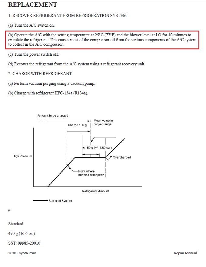

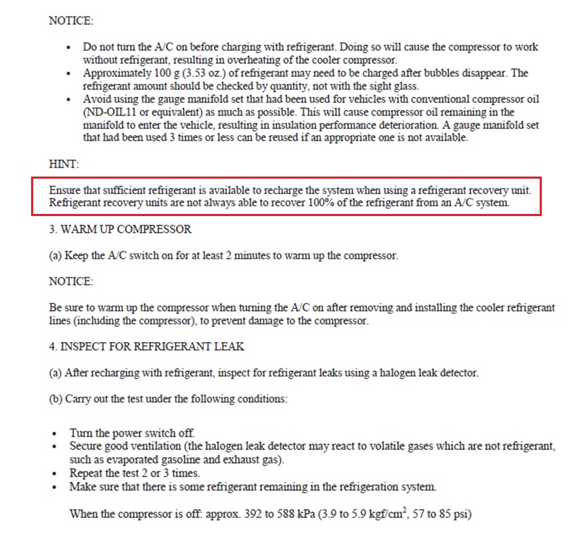

    This was only a couple days ago, so Maybe I can take some remedial action. For example: bleed about half of the refrigerant as liquid from the high pressure side into my recovery tank and then replace that with fresh R134a. That should remove some of the oils. If I remove half of the refrigerant each time after 4 cycles, I'll be down to 10% of the leak stop. I'd need to add back some proper oil to make up for what was removed. How crazy is this plan?
    Another question.
    Is the "conductivity" issue with the conventional PAG oils (v ND-11) due to them being hygroscopic (wet)? I'd think think there is a drier in the system.
    In my residential HVAC with R410a and POE oil, the issue is water. In that system the windings of the motor are also exposed to the refrigerant. If it is "wet" then you can get electrochemical corrosion of the wires. The metal ions then released into the oil increase the conductivity further leading to compressor failure. Anyway, that's why after opening the system you replace the drier, keep it purged with dry N2 while working in it, and pull a good vacuum on it before recharging.
