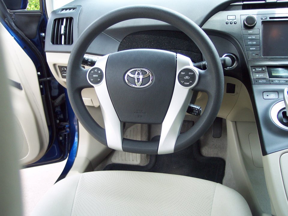

    Sneak peek at my latest mod - lowered tilt steering wheel. Oh, this is so much more comfortable. Your hands can be resting in your lap yet still easily access all the steering wheel controls. It's almost like driving a go-kart!

    And, PhoenixGreg, that air bag alignment is going to do you some serious internal injuries, should you ever be involved in a collision which causes deployment...

    Possibly. I would not recommend this mod for any female drivers who are pregnant or may become pregnant as the air bag deployment would be slightly lower. I'm not much closer to the wheel this way as the OEM way, but I do have another concern. By lowering the steering carriage, I may have impeded the proper function of the "crush zone" that all steering columns have during a frontal collision. It depends on where the crush zone is...I did not see it during my mod so I'm assuming it's under the hood.

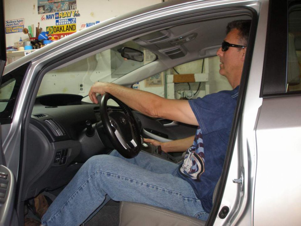

    " In my Prius ..... mad sad room for my knees .... " ... let's see it all ya'll 6' to 6'6"+ driver's sayin' 'I'm good in mine'. Wrist over wheel, no leaning forward, post up yer pics.
    15" from airbag, plenty. Full out, down, 6 notches slid forward, not cool. :rolleyes:
    'Midsize' car sits like a 'compact' compact. Come on Toyota !!! :mad:
    OMT .... mount column higher in dash so face more vertical, not partly like bus.

    I don't know if you can lower your seat, but if so, my mod would make your hand positions much more comfortable. I'm only 5' 9" so it works for me. But I realize having the steering wheel practically in your lap maybe too extreme in the other direction.

    It wouldn't hurt that's for sure.
    short of it -
    Need ta lower front edge seat bottom too much tilt, no go w/ mech seat. then could bring up seatback a tad, the way to lessen de reach.
    long -
    Toyota seat tilts vary thru height adjustment from flatter (up) to lot 'o tilt (down), unlike Honduh. In power seat, it's redundant cause front of power button is cushion tilt feature. Can power knob then flatten out cushion enuf? Bro above says no. Is what it is, but no likey. Better to keep same cushion tilt through mechanical and power height range.

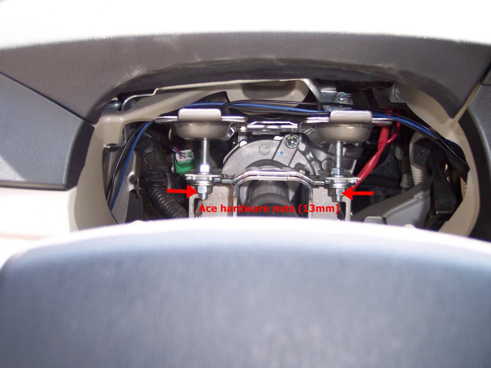

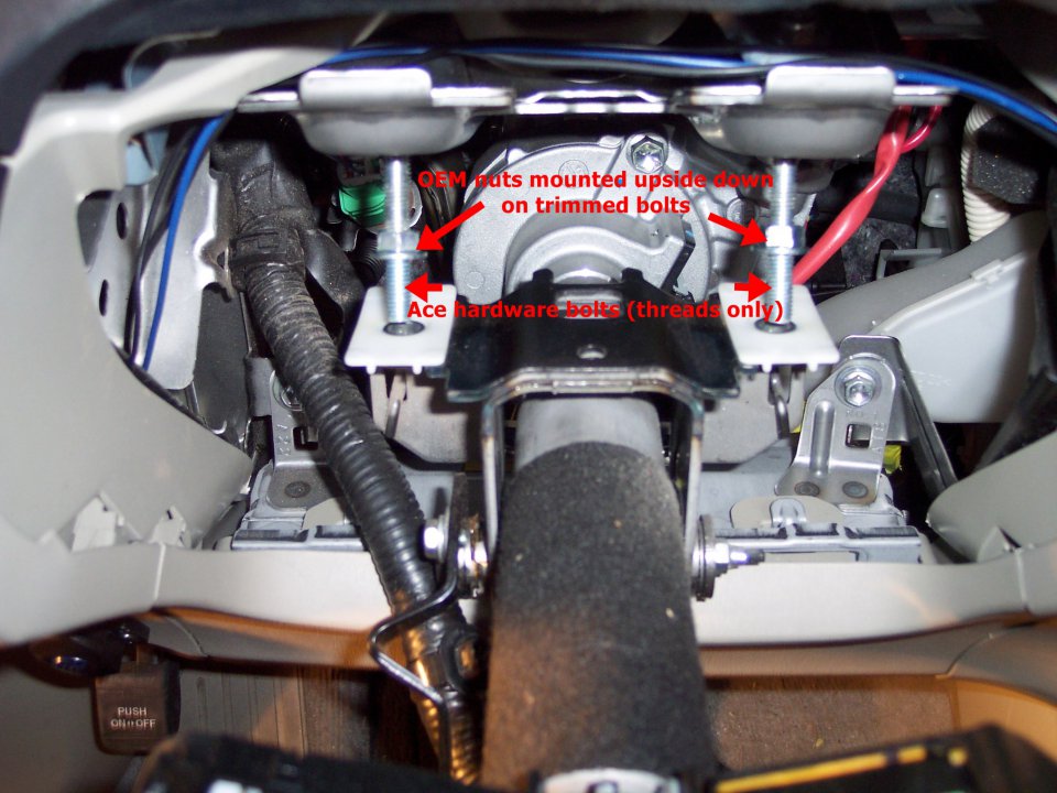

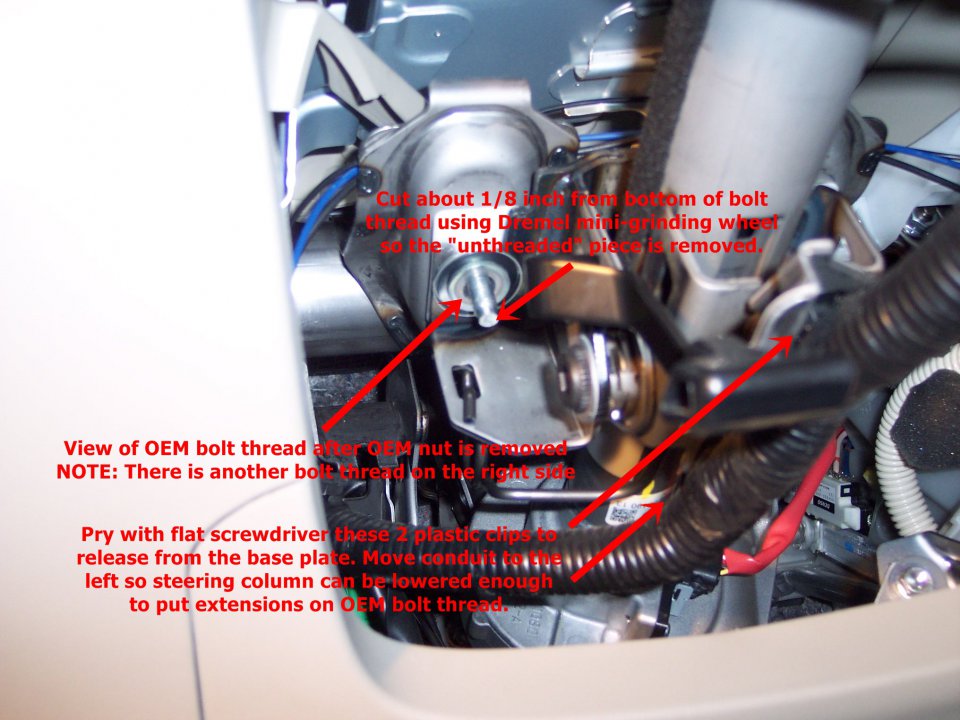

    How'd you do it? Replace slider piece for one with longer slot?

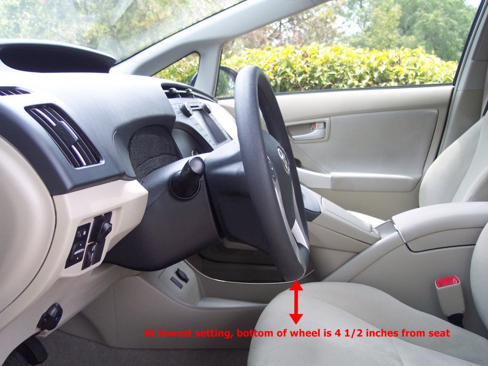

    I considered that, but that part of the mechanism could not be removed from the column and could not be altered to allow more tilt adjustment. My concept was to lower the entire column by extending where the OEM bolts attach on the bracket. Here are some pics, but I don't suggest doing this mod as it could have affected the how the safety crush-zone functions during a frontal crash. Add to that, the mod could be dangerous for any driver who is pregnant. Also, with my mod, you have 2 settings: Low and Really low!
    Parts I needed were 2 M8x70mm bolts and matching nuts 1.25 pitch (metric) from Ace Hardware. The foam filler required an elaborate template with careful cutting to get a nice fit. Then I sprayed the foam flat black - several coats.
    DISCLAIMER: DO NOT ATTEMPT THIS MODIFICATION
