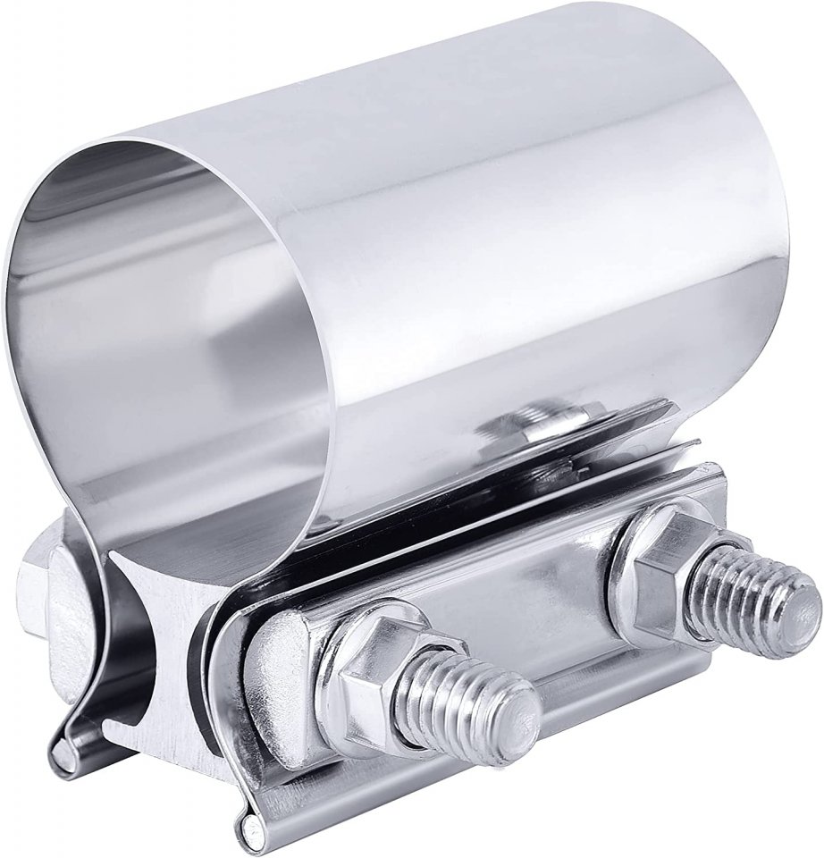

    4. Connect the end of the new cat with a stainless steel exhaust butt joint clamp like this one sold on Amazon.
    Exhaust Clamp,Butt Joint Band Clamp Sleeve Coupler Stainless Steel
    Using this method, there is no need to disconnect either battery for welding, because the exhaust system is isolated by the rubber exhaust hangers. No coolant needs to be drained. And, only the catalytic converter needs to be removed.
