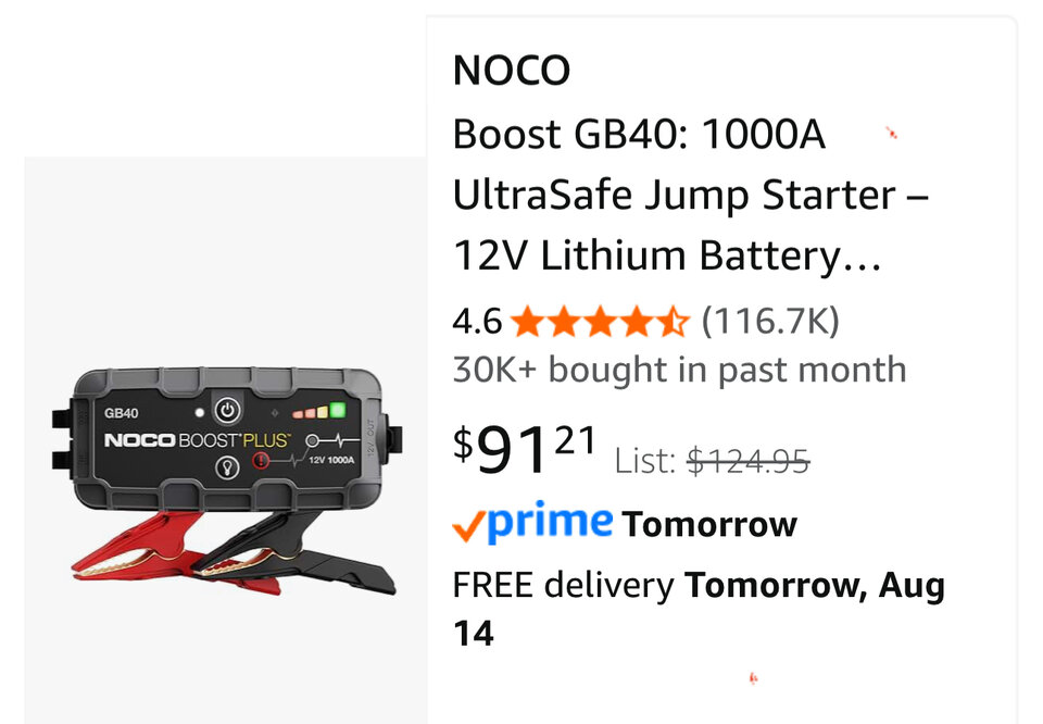

    As noted above, a hybrid won't go to Ready if the 12v battery is discharged. My experience is a Prius agm 12v battery will get very intermittent when it is used up. The easiest test is to remove it and take it to an auto supply for a free 12v load test.
    If a 12v jump "starts" it you know it's the 12v battery causing the immediate problem. It does not take leaving a hatch light on to cause this if the 12v battery is bad. Jumping a Prius can damage it if jumping from another vehicle and the cables are reversed even for a second. The best way is with a 12v jump box with safety checking.
    In almost all cases, a "low capacity" hybrid battery will still spin the engine to start it. If it can't you will get a code.
    That does not mean a weak hybrid battery will have much capacity left. A sign of low capacity is the engine running at a traffic light to recharge the hybrid battery. A good hybrid battery can almost always run the car by itself at a traffic light for three to five minutes.
    Bottom line - load check the 12v battery first. Second you may have a weak hybrid battery.
    Jump starting a Prius gen2 from owners manual. It shows jumping from another car battery. Using a portable jump box is far safer. I keep one in both of our hybrids.
