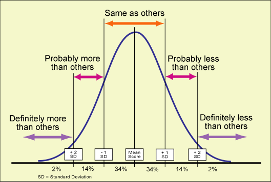

    In nature, many observations follow a 'Bell curve' in distribution:
    Usually there is one weak module that fails first. Replacing it simply means there is more time for next group of weaker modules to fail and this is what has been reported. Eventually, the weakness propagates until all but a handful of modules, remain. But every time there is a module failure and the car taken out of service means the normal, operational recharge mechanisms are missing, further weakening the remaining modules.
    There comes a point where any part has reached its operational life. Fortunately, we have a lot of experience with understanding these traction batteries and replacement modules from crashed Prius remain in steady supply. Just find a credible rebuilder, one who screens their modules and ranks them by Ahr capacity to build a balanced pack. Expect to spend ~$2,000 and life is good.
