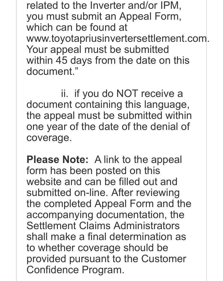

  16. rjparker
    rjparker Tu Humilde Sirviente
    Jun 6, 2008
    9,285
    5,655
    Texas Hill Country
    The rental car is not covered in Toyota's 15 year warranty extension but IS covered in the Class Action Settlement on the inverter. Some sources suggest you had to own the car as of May 2022. This was clarified later to include subsequent purchasers.
